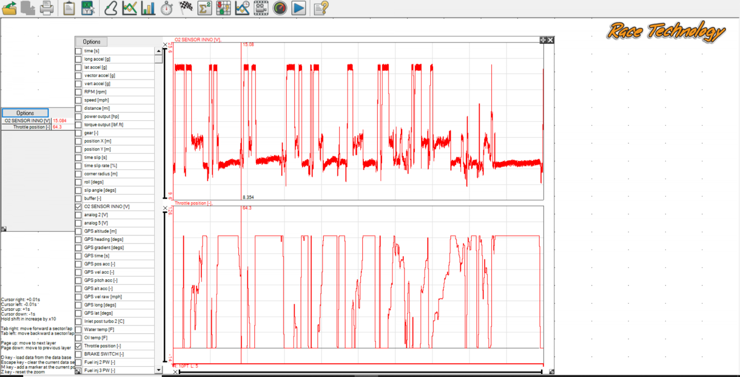

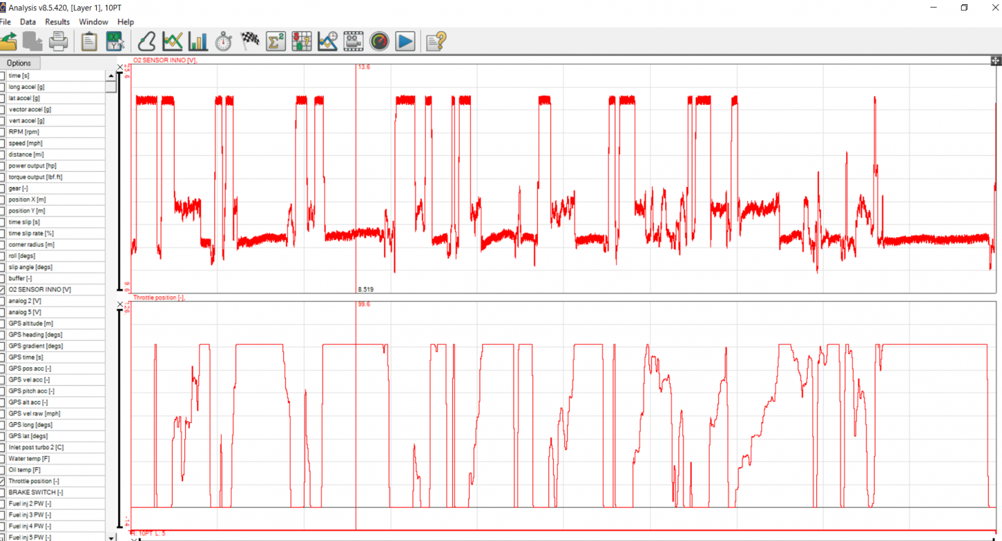

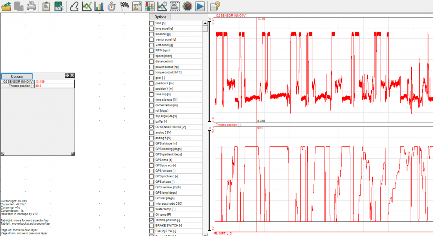

    The engine has on the intake side a Cat Cam 280 and stock S54 exhaust . So far managed to alter the fueling map KF_TI_N_RF_VL while on a dyno session and i was able to richen the mixture but at part load KF_TI_N_RF_WL (is this map the the part load KF_TI_N_RF_WL?) no matter what i did i was not able to correct the fueling . During cold start enrichment AFR stays between 13.6- 14.5 afr and as soon as it engine is warming up 50-60 degrees F ( engine temp) mixture goes to 16 -17 AFR ) .I have attached a screenshot of a log ( throttle vs AFR ) . The o2 sensor logger is correctly calibrated and displaying correct values .
