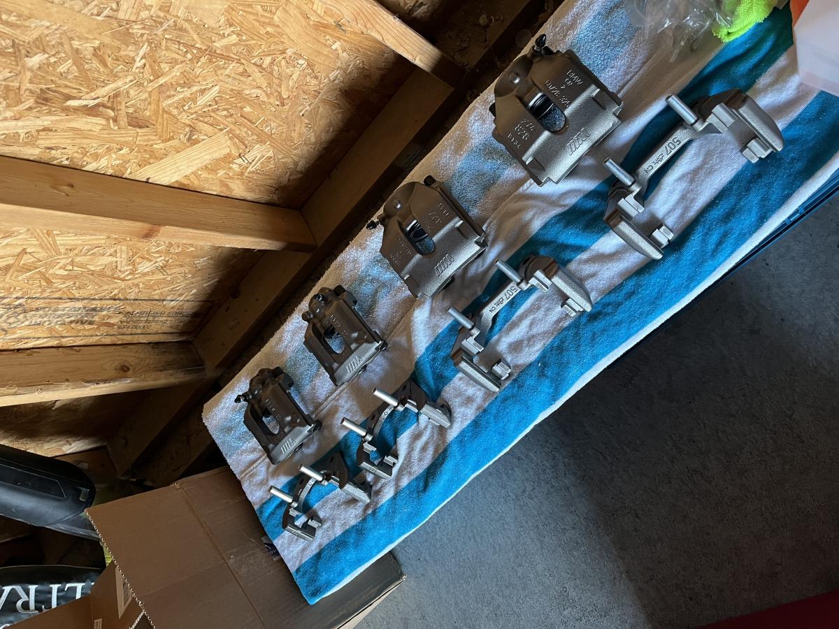

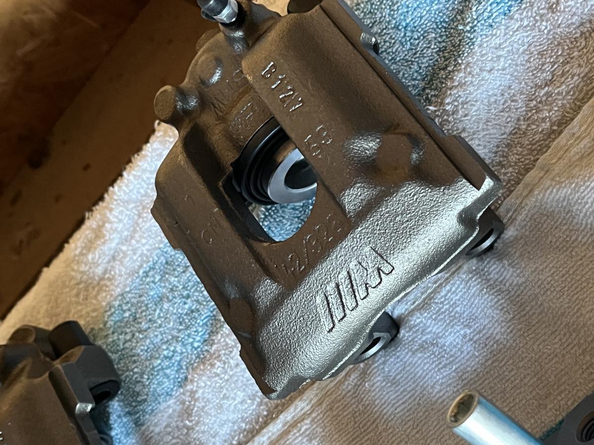

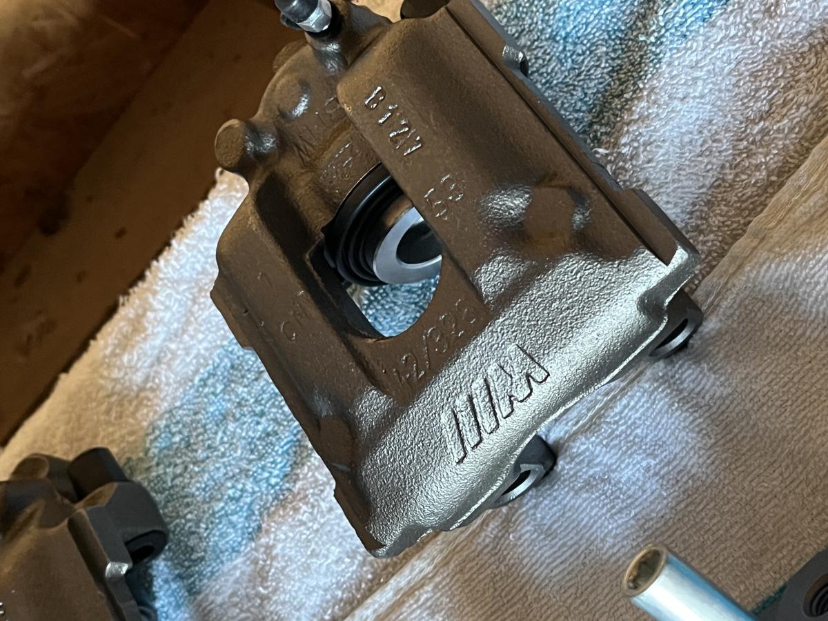

    Original plan was silver plus clear caliper paint. Does anyone have any insight on the coating they use for these remans? I’m inclined to just clear over the existing coating. I’ve had remans that turned brown after a few months of driving looking to preserve the look a little bit.

    This is my E53 on unpainted remans (they were claimed to have a corrosion inhibitor finish). Luckily it was easy to knock the rust off before painting them with with G2 caliper paint. The results, I think, are fantastic for a brushed on finish.
    Remans definitely need something. I think gray iron looks nice, but I'd paint them with a good 2-part (activated) black or silver caliper paint. I have not seen a good clear caliper paint.
      Absolutely paint them. This is the perfect time too. You can assume that whatever paint is on them will not prevent any corrosion. Be sure to get brake caliper paint. I would even recommend painting the caliper clips too since they will also rust.
        The brush on G2 caliper paint is excellent for OE calipers. Just be sure to mask off the machined surfaces and where the pad slides on the caliper and bracket.
