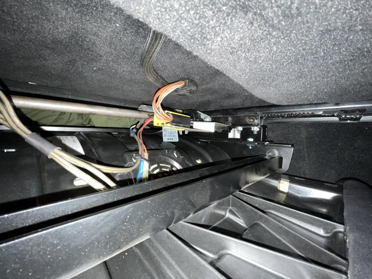

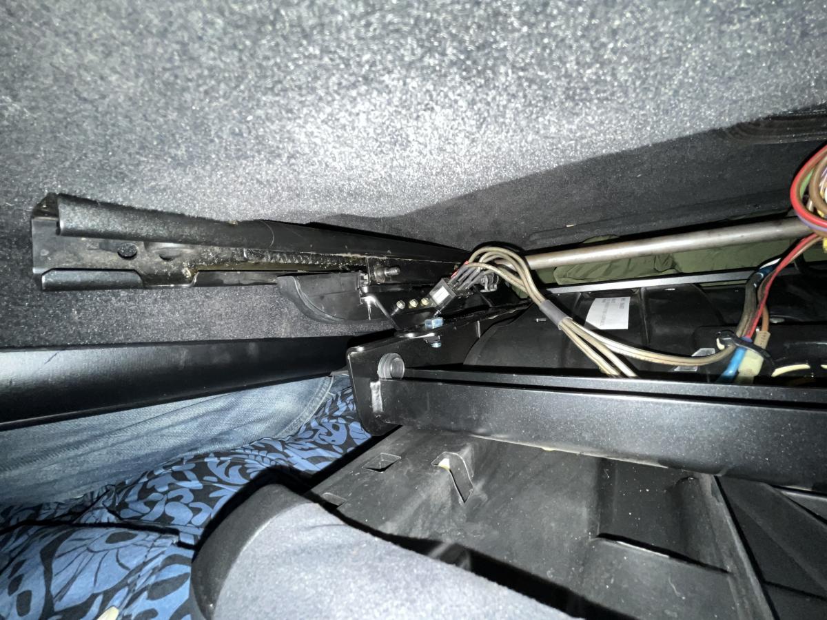

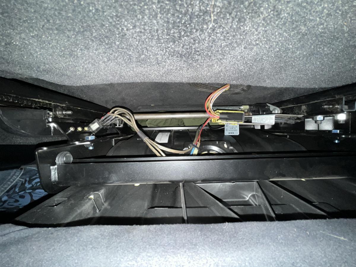

    Hi. I'm working on putting oem power rails paired with Brey Krause mounts on a Recaro Sportster CS seat. Does anyone have pictures of a similar setup installed?
    I've got it all mounted together but when I put the seat up on a flat surface it's not even. The seat wobbles a little which leads me to believe I did something wrong.
    The instructions mention to install a sub strap or use the two hole 4.5mm spacer included. Does this need to be installed if you use sedan rails?
    Thanks,
    Jay
    Hope these help!

      Exactly what I needed. Thanks!
