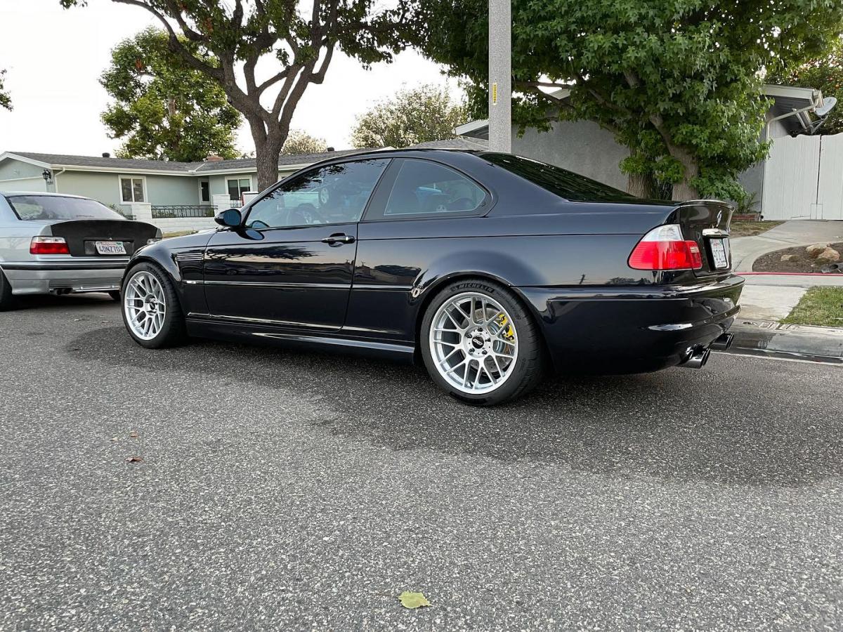

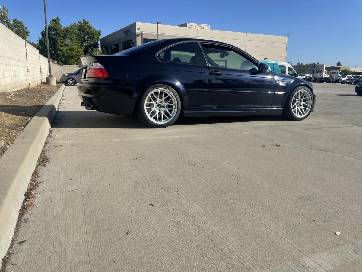

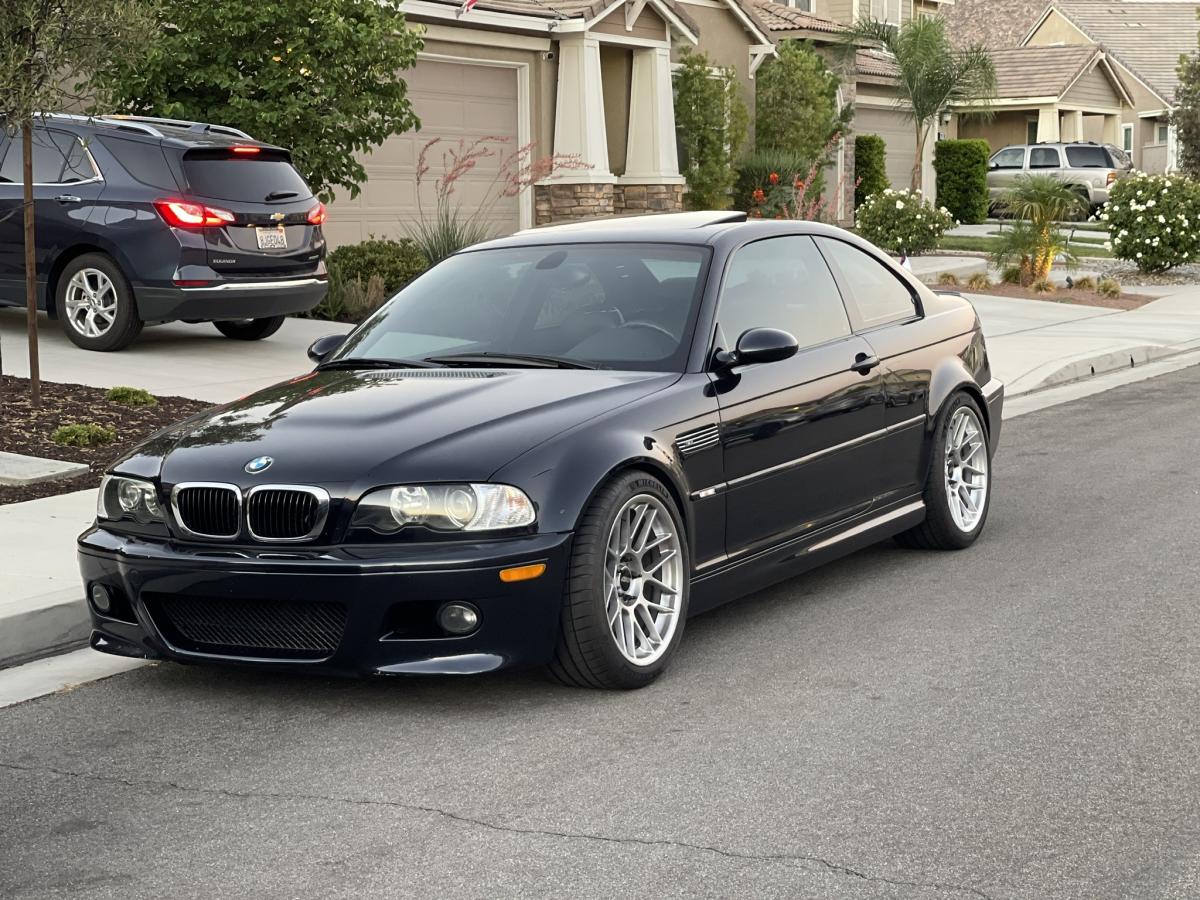

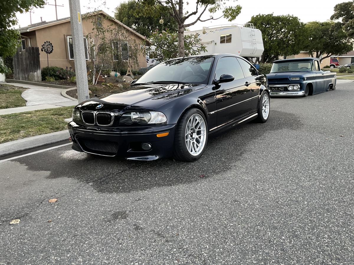

ID:	223536Currently running 18x9.5 et 35 on 265/35. Love the fitment. Running 12mm rear spacer and 3mm up front to clear coilovers. On oem suspension this spacer isn’t needed. Stock strut mounts pushed to max chamber. For some additional clearance. Front is perfect fitment, no fender modification. Rear has tons of space and will likely up it to a 15 mm spacer soon. Definitely go sliver, dark cars need the contrast, hyper silver or go for the forged one and get the brushed. Can’t go wrong.
            Another angle
