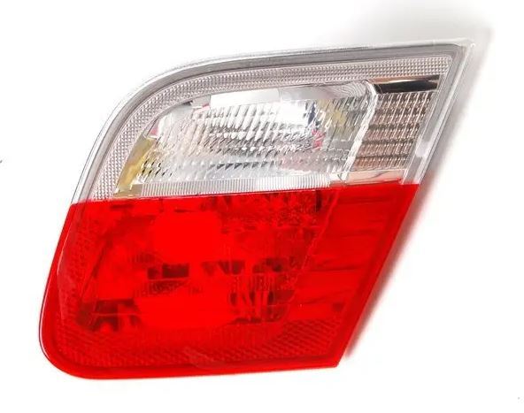

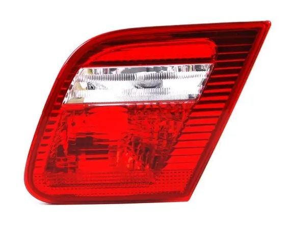

                  Is the trunk bulb carrier the same for both pre and post facelift models, with the only difference being the lens, which is also interchangeable?

                    Yes, same bulb carrier. Different Housing.
                      What do you mean by different housing exactly...
                      Basically, I am trying to ascertain if the pre-facelift bulb holder will fit the post facelift trunk light as pictured above?
                        Correct. Only parts you need are the two housings (or 'lenses' as you called them) Left taillight inner p/n: 63216920705, right taillight inner: 63216920706
                        Everything else is the same, nothing else required to convert in regards to the inner lights. I only say housing instead of lens as if you look at your current ones you'll notice the part surrounds the bulbs and is more than the plastic cover that is visible.
                          Thanks Thoglan... and yes, housing seems to be the more appropriate term.
