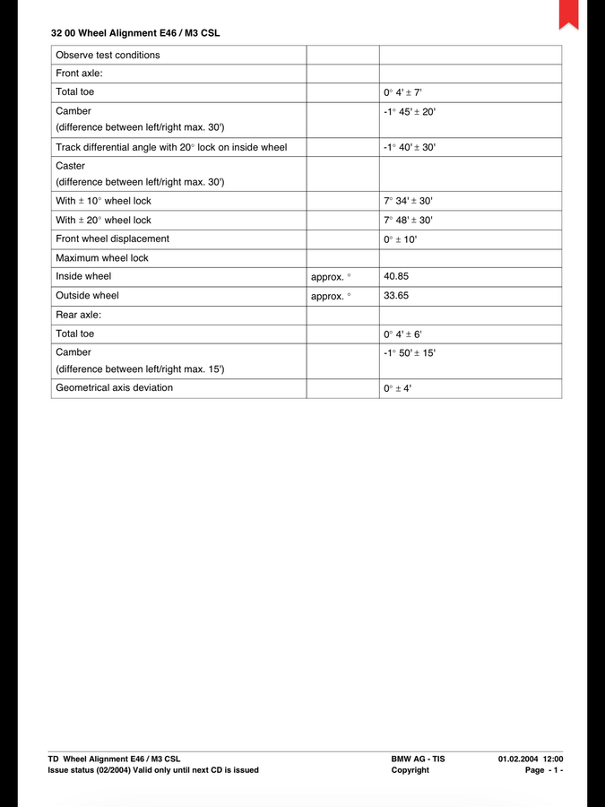

    Hi everyone, I'm hoping to get some alignment advice. I recently installed an Ohlins R/T kit and my car is going in for second alignment on in a couple days. I'd like to know people's thoughts on alignment specs (camber, toe, caster), based on the information below. I'd like to use it as a starting point, and then tweak it from there as necessary.
    My target ride height is 13.5 in front, 13 in rear.
    I'm running 19 inch wheels with stock tire size - 225 / 255.
    The car used to be a daily driver, but is now used mostly on weekends for sporty driving on back county roads, with the occasional autocross day (1-2 per year).
    Insights would be greatly appreciated. Thanks so much.
    Andrew
