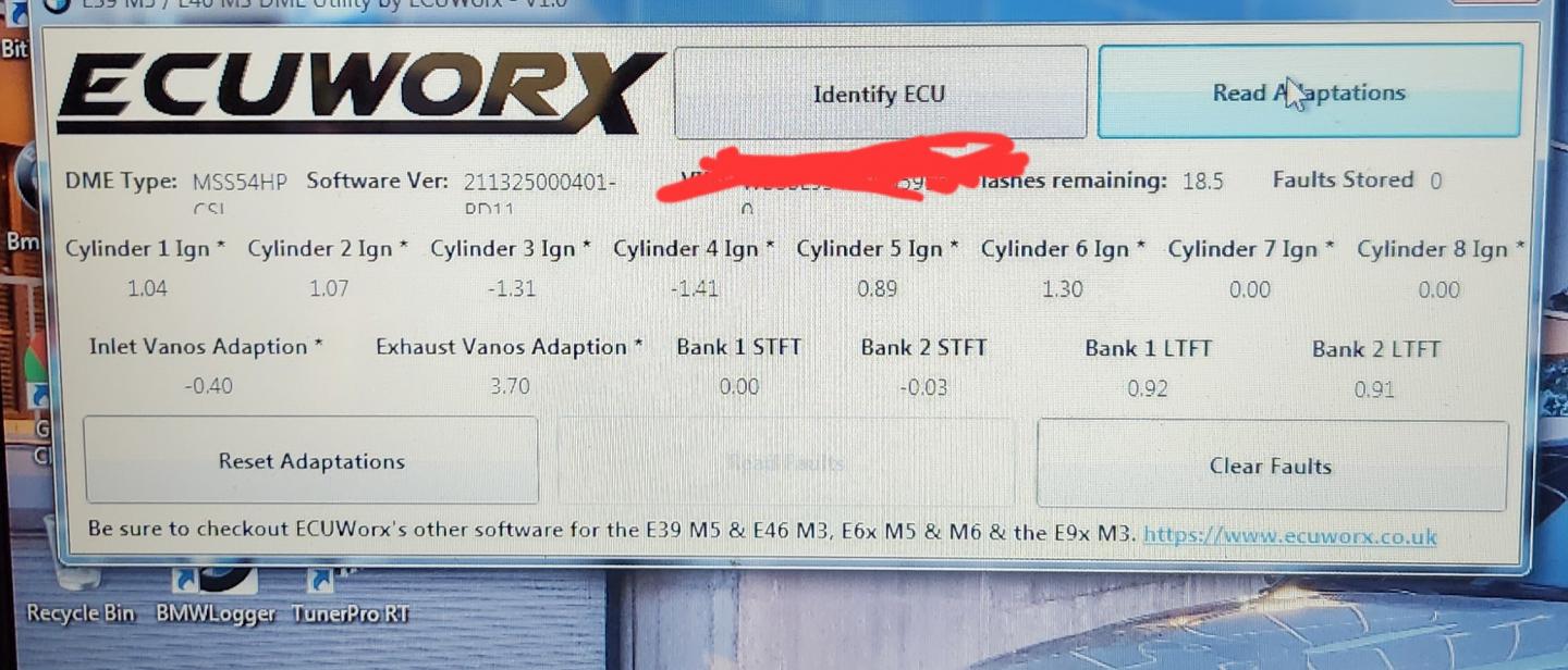

                  FWIW here's a snapshot of the fuel trims etc. after some somewhat spirited driving around town last night for about 45min.
                    The ECUWORx tool shows STFT2=-0.03 and LTFT2=0.91
                    These number seem to be so small and should not cause a lean code. If ECUworx has STFT in ms of pulse width then without knowing the table or calculated injector pulse width then giving STFT in ms makes no sense as we have no idea what percentage 0.03ms is from the calculated pulse width.
                    And if both STFT and LTFT are in percentage, then these value cannot cause a lean code as they are too small.
                      I have to disagree, near 10% less fuel can indeed cause a lean condition. Especially with a (canned?) tune, I suggest to contact your tuner (HTE), because with 8 and 9% LTFT your map has rich spots where the ECU adapts the fuel down and multiplicate this trim also on WOT events where o2 correction is not active. In my opinion 2-3% fuel correction is okay, but not near 10% on a narrowband dme controlled engine!
                      btw do you have your WBO2 on bank one or bank two? Or do you have dual channel WBO2? Sometimes a injectors starts clogging and cause lean conditions on one bank, but as you the both fuel trims relative bad, I don’t think this is the case.
                        The wideband is only on bank 2, I'll have to reach out to HTE and see what he thinks after I send a few logs as this car was dyno tuned with all the current modifications.

                              My ltfts typically sit near 8-10 on each bank, have for years, and I have never gotten any sort of lean code/warning. Interesting.
