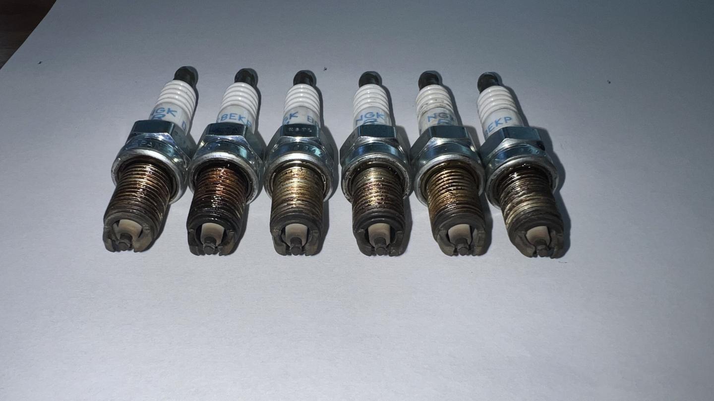

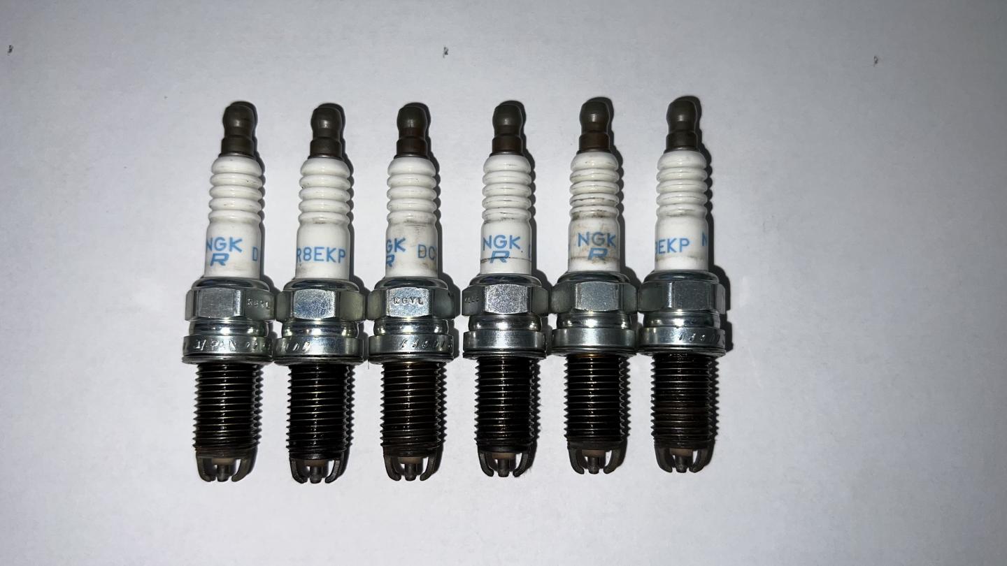

    Here are some photos of the plugs that they pulled and a short video of it driving - they all have oil on the threads, but all look to be worn the same - I have no idea which ones are 5 and 6 as they're not labeled, but from what I can tell they all have the same wear on them. For now it'll be parked under its cover until I can get this thing worked on.

              3. All of the plugs look the same and not too bad. I would have a second shop to check.

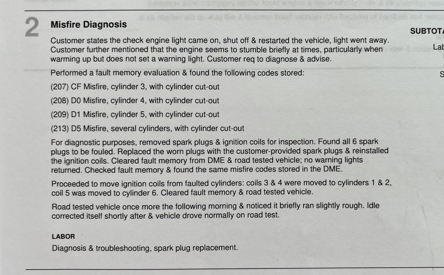

                    Are you able to post all the codes your getting if it's more than just the misfire codes? Headgaskets are a big job as I'm in the middle of it right now. Another engine is literally cheaper than the labor.

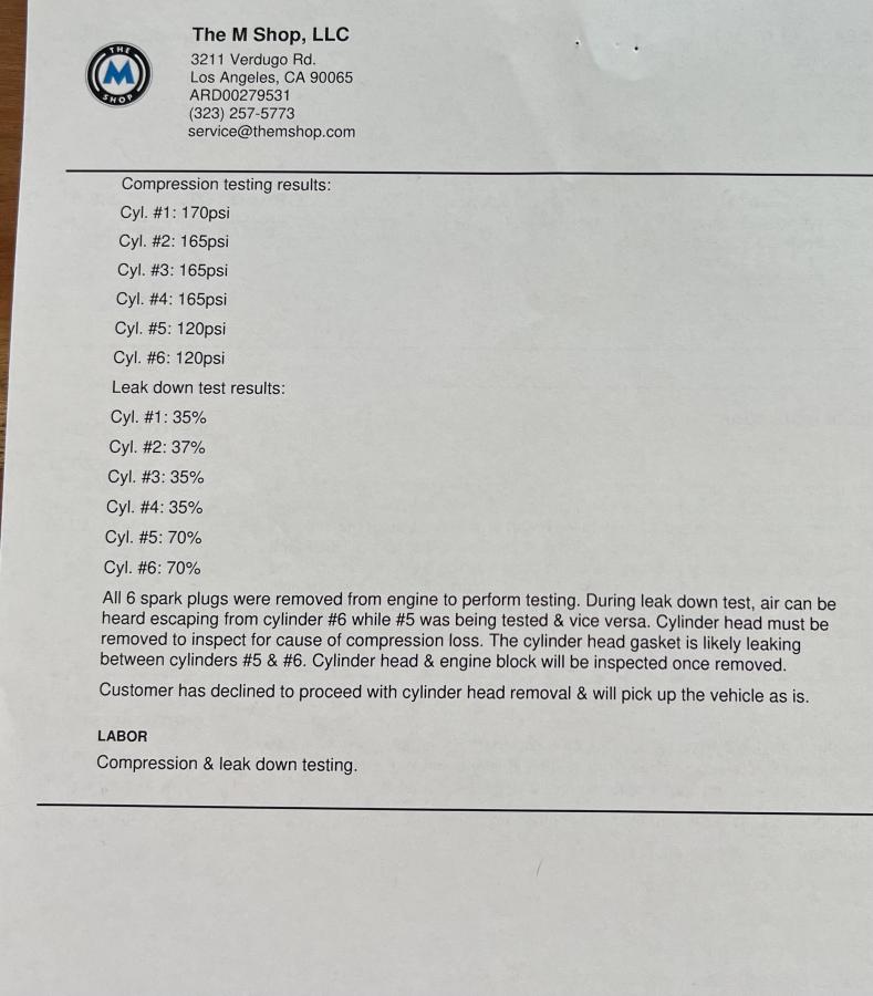

                      Below are the two reports I got on the compression, leakdown, and the misfire codes. Sorry to hear you're in the middle of it, yes they certainly sound like a PITA

                        Just FYI, misfire is typically calculated based on (lack of) crankshaft acceleration. Given the firing order of the S54, 1-5-3-6-2-4, it's entirely possible that the ECU will throw a code for misfire on cylinders that don't have misfire. I believe this is what sapote is getting at above.
                        Cylinder 3 misfire code doesn't provide any evidence against a blown head gasket. Keep in mind that you're doing further damage to the head and block if the head gasket is blown by continuing to drive the car. Maybe I've missed it but has anyone suggested looking at the coolant or testing it for combustion gasses?

                          The head gasket failure is between 2 cylinders, not between cylinder and oil passage or coolant passage. The only way to test for this is via a leak down test.
                          You could try using a borescope with a 90 degree camera to try and see if theres any visible damage to the head gasket. Maybe shining a bright light into cyl 6 while bore scoping cyl 5 would show it.

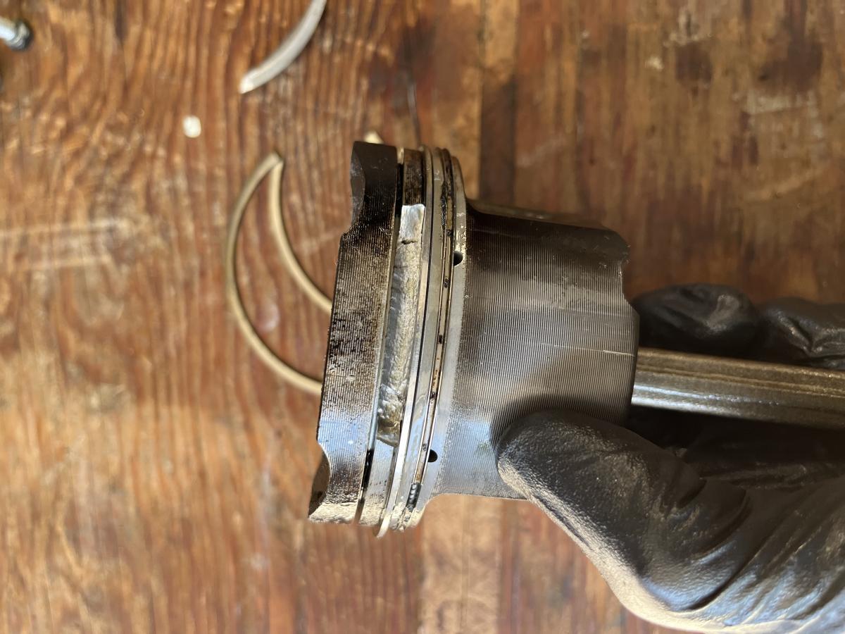

                                I just pulled this out of my engine a couple weeks ago. Car had no misfires or drivability concerns. Only indications that something was wrong were low dyno numbers (~30hp down from similar setups) and when I did a compression test everything was at 165psi except for cylinder 5 which came in at 145psi.
                                I don’t mean to scare you, just showing that sometimes bigger issues might not cause a misfire condition.
