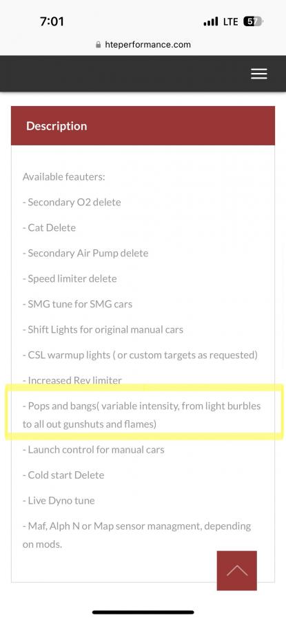

      Are you tuned for light pops/burbles? Saw Hassan has that service listed (light pops all the way up to gun shot sounds) on his E46 Tune package.
        I don't believe so--I didn't ask for it and it never came up in discussion.

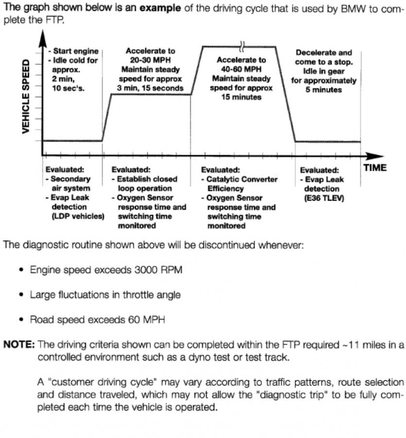

              You have to complete a drive cycle. 55mph for 15 minutes will turn the O2 monitors on and ready.
              Do not go over 3k RPM’s getting onto the freeway. If you do, pull off and turn the car on/off before getting up to speed. Keep the OBD2 reader plugged in - you’ll see the O2 monitor light turn green between 10-15 minutes cruising at 55mph
              save this graphic
                  save this graphic

                  This is exactly what I have tried numerous times now. O2 Heater monitors should set ready almost instantly but because the heaters refuse to set ready the o2 sensor will not either.
                  I have been able to confirm heaters are functional with mode 6 data but they refuse to go ready.

                          PS just saw you earlier comment from a few days ago. The car isn't tuned for any burble at all. It only started to pop after changing the o2 and as of now I am chalking it up to being related to whatever is going on with preventing the o2 heaters from setting ready.
