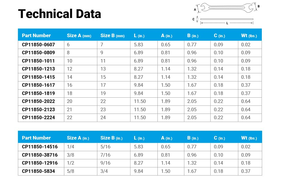

          The Capri super thin 18/19mm will absolutely work. I have it just for the links.

              Do you have the same Lemforder links with the shoulder shown in the picture (the area covered by the bottom the the "F")? I measured the flat from the edge to the shoulder and can't get a measurement of more than 3.90 mm. The Capri is advertised as 0.18 in, which is 4.572 mm for the 18/19, so if that's correct, it wouldn't fit once it's installed (and would be pinched between the link and the strut/sway bar during installation). I had 2 difference links installed on my car that I just removed, and I was able to use a full sized wrench on those. I would have loved a reason to get a set of the Capri's, but for now I just grabbed a set of "Grip" from Princess Auto since it was on my way to pick something else up today. I'm not concerned at all about a low quality tool being able to handle the installation, but I will be worrying once I need to remove them after they've become all rusty and crusty.

                Yeah, same Lemforder links. You do have to yank it off once torqued though. It is pinched a little bit, come to think of it. But if the boot doesn't tear, I don't see the harm. Maybe go with that BMW wrench. But the Capri will work.

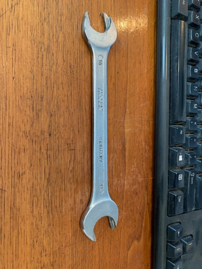

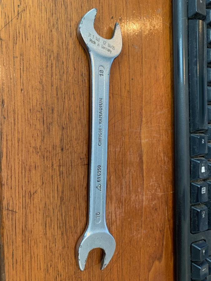

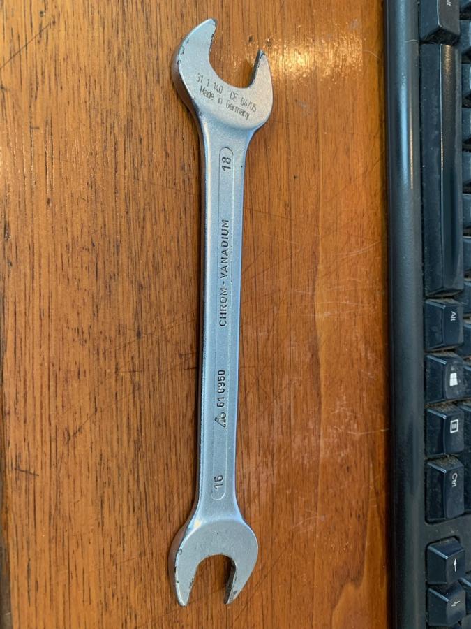

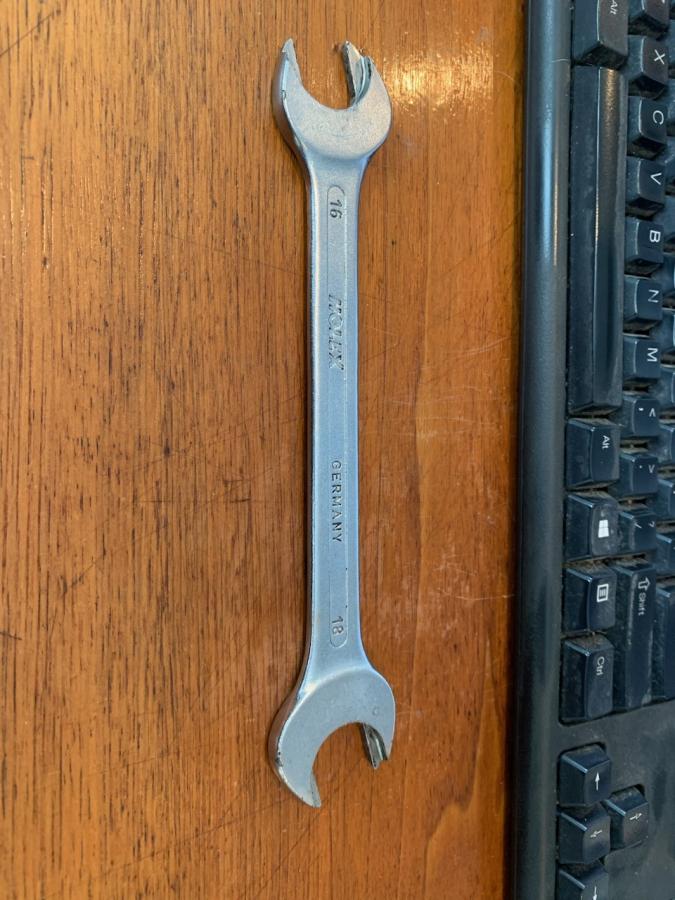

                      BMW had a tool for this, it's basically a 16/18 with a portion milled out to allow it to fit. BMW tool number 31 1 140, I think the pn# is 83300494826 but has been discontinued. Just a fyi for anyone in the future.

                      Email to [email protected]
                        Nice, so the size is 16mm flats on front, and rears are?
                          Yup, went to a bike shop and bought a cone wrench.
