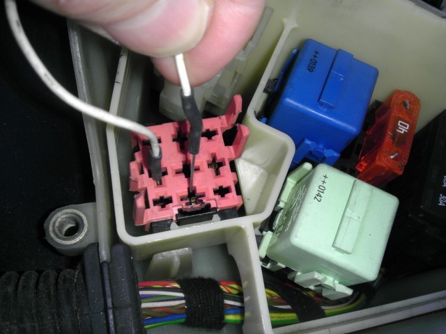

                  For sure the pump can't run with the relay unplugged, but I always thought that's how the pump sounds. I will use INPA to activate the pump and listen to the sound.

                      I can't comment as whenever I work on the car I remove the negative battery terminal. You can do this to fire up the motor without the relay since you are simply wanting to hear the noise it makes.
                      Click image for larger version  Name:	wire-jump-smg (1).jpg Views:	0 Size:	65.4 KB ID:	230111
                          This will work, but ideally I want to hear the noise with the hood closed and the driver door opened exactly the same condition to help identify the noise.
                          Also, jumping the relay as you did -- can this cause the pressure too high? I know the system has the pressure sensor and so the controller might read the sensor and cut off the pump when the pressure is reached, but is there a pressure relief valve in the system to prevent over-pressure?
