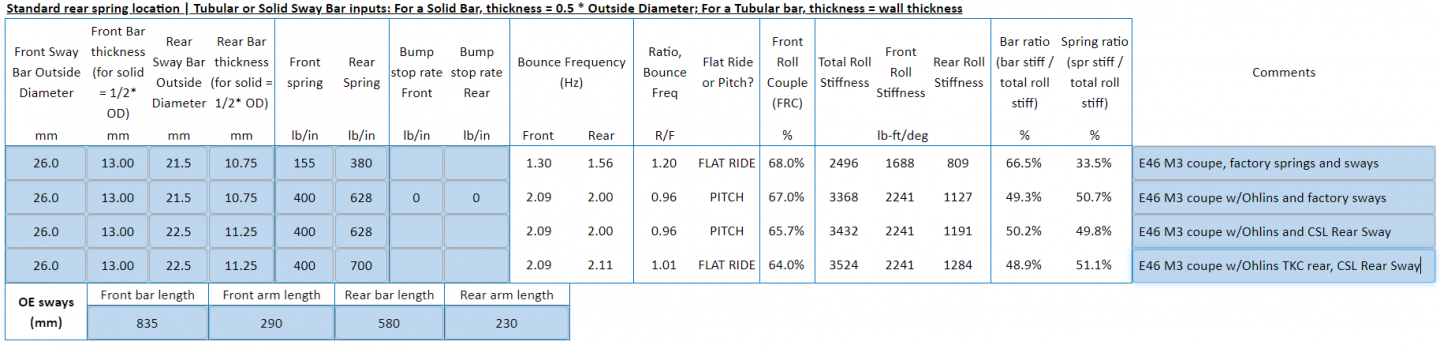

I am interested to learn more about Total Roll Stiffness as calcuated in the FCM Ride Harmony tool, because that number changes significantly with the mods I'm contemplating. I have the GC Front Bar on/order, I have 700# TCK rear springs on/order, and I have a CSL rear sway in the garage as an option. I do not intend to test a different spring rate in the front.
Question: how much total roll stiffness can my car with PS4S tires handle? Will overall grip be worse most of the time with a 50% increase? Going from Ohlins with an OE front and rear sway (3,368 lb-ft/deg) to Ohlins with a GC Front (5,318 lb-ft/deg) is a substantial change mathematically. Is it reasonable to think that at some point the front bar stiffness is great enough that it's only beneficial with track tires? Let's assume as an intermediate driver I'm going on track on dry days. Do I need to leave the GC front bar off until I get stickier tires?

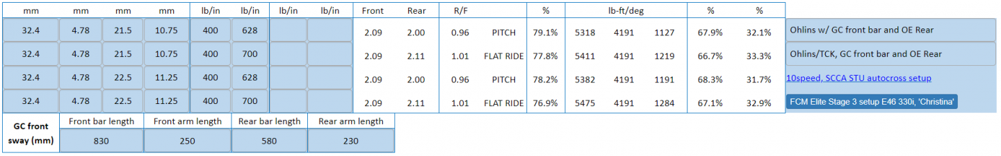

So the options look like this:
Or this with the GC Front Sway on Soft
