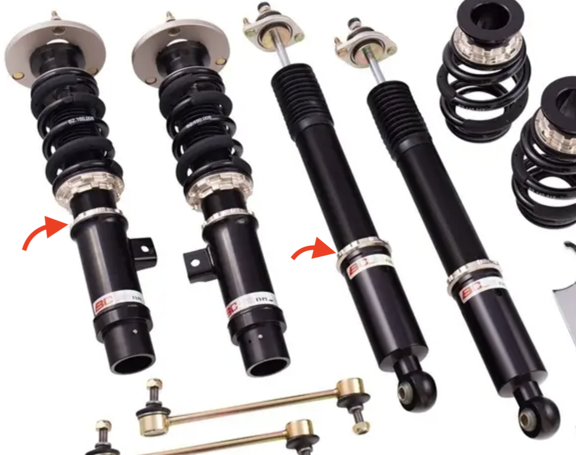

Originally posted by Obioban View Post
I assume only on the rear-- no?

Originally posted by YaroM3 View Post
The fronts you can adjust them with out messing pre load. You set the pre load before you install the coils. In the rear is different because you have a spring and shock instead of it all being one unit. (True coilover) as some call it.
How do you change preload without changing ride height up front? Does the shock mounting position changing?

Originally posted by pb_e46 View Post
I recommend all of this as well as checking your preload setting, The only point I didn't see people mention is that fact that sometimes (a lot of the time with E46 swiss cheese chassis) that it's not even. Lots of my friends and myself have had to adjust our coils to non-symmetrical measurements to achieve the same gap. If you can't get it with the aforementioned, just adjust it to match.
Originally posted by speedster View PostFor what it's worth I also have BC's and my left rear sits a bit lower than the passenger side. I've adjusted the height on several occasions but it seems like the driver's side always sits a bit lower
