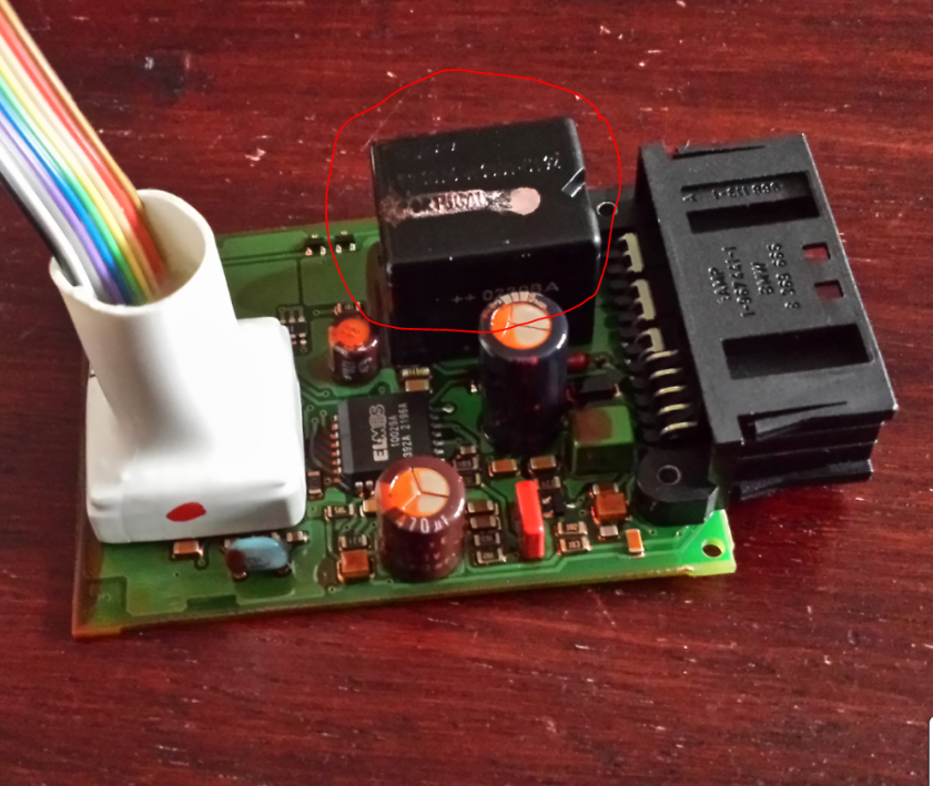

    I previously posted about my no crank no start issue. I believed it had something to do with the clutch switch. Turn out I was only partially correct. I depress the clutch switch and traced a clicking sound to the Ews. I tapped the Ews a few times and she fired right up. Is there a relay or something in the Ews that can be swapped out. Can that part be coded out preferably with inpa. What are my options
    I think there is a relay in on the EWS board to supply the high current to the starter solenoid, and its contacts probably pitted and need a clean job. Post the pics of the red circled part which I think it's a relay.
