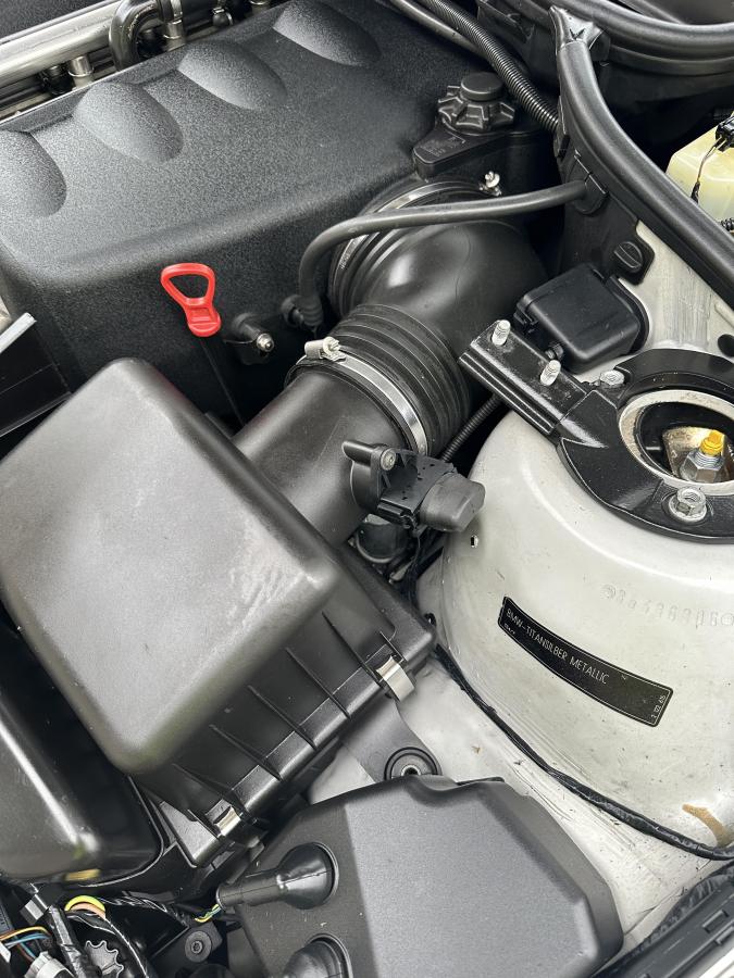

        Can you post a picture of the setup?
            From what I can tell it's pretty much stock. Anything else that I should look at?

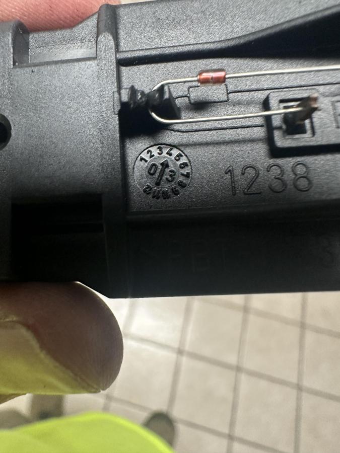

              I don't have a known good one besides buying a new one. But after pulling it, I might have found at least some of the problem. I am pretty sure I am reading this date code right but that looks like 04/2003 correct? That would make this the original MAF if so.

                Yes, MAF is original from 2003 and the engine bay wiring looks stock.
