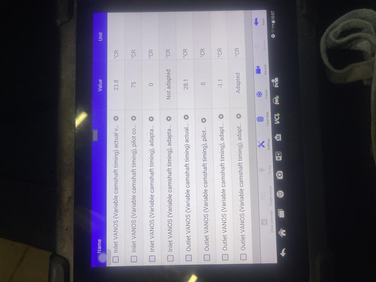

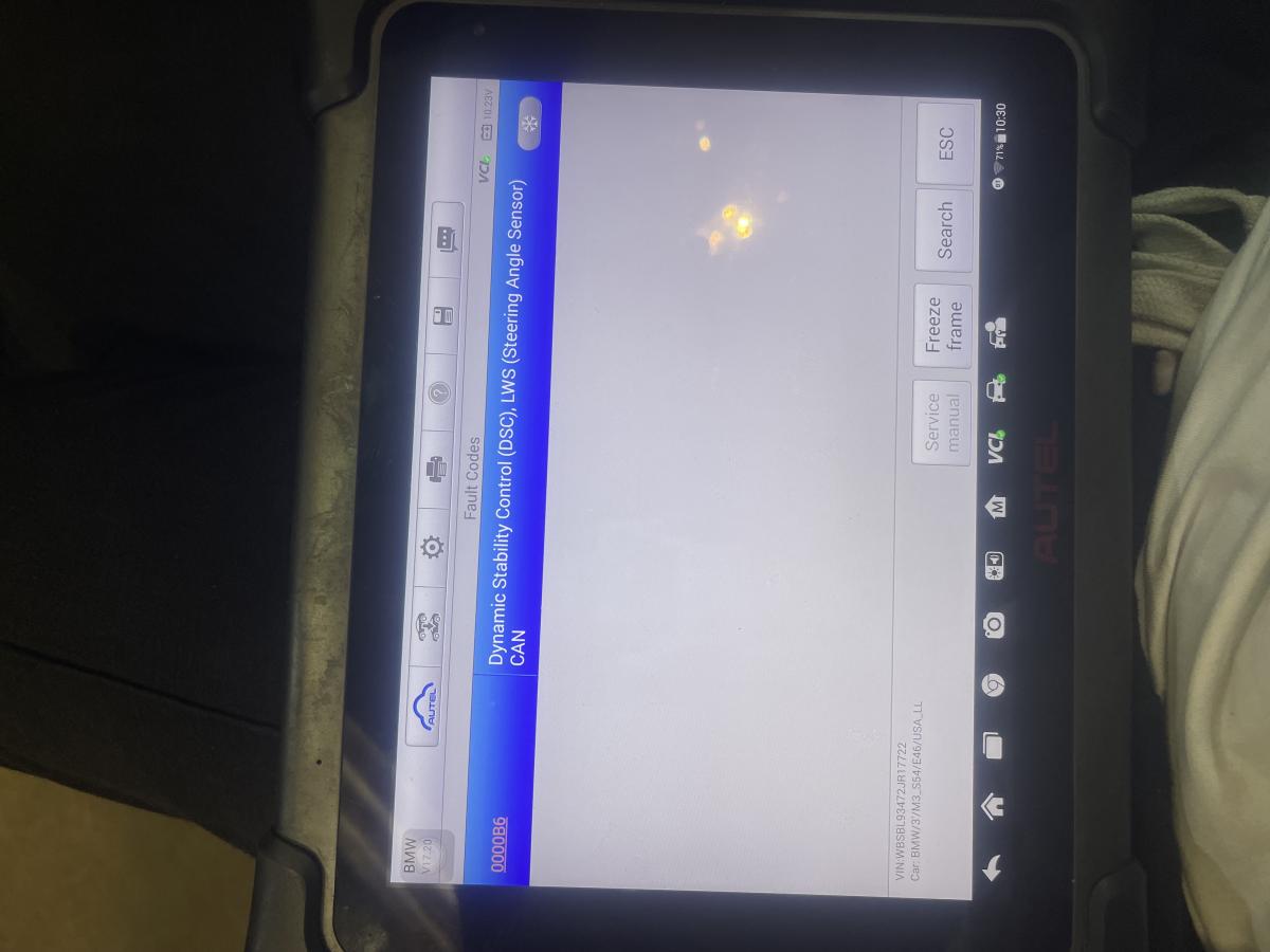

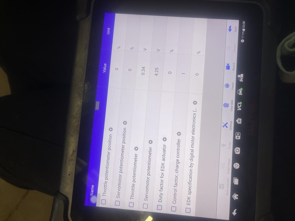

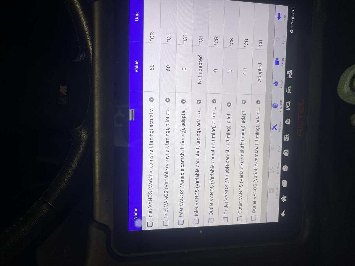

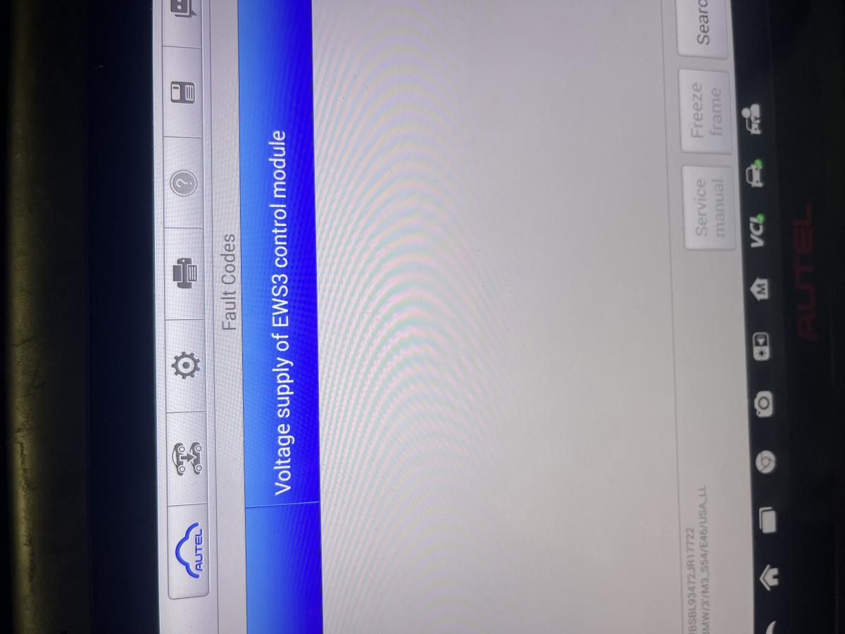

ID:	232899 everyone I’m new to the group I’m having hard time finding the issue on my car took it to couple shops still no results,its running rich strong smell of gas when the car is on it’s like it cant adjust at idle I ran Autel scanner and test vanos it says inlet vanos not adopted I did also clear vanos adoption,my car is fully build HPF stage 3 single turbo pro efi 128 stand alone also tuned I didn’t rebuild the vanos
            do u guys think if I cleared the vanos takes the tune off ,I’m gonna change the camshaft sensor on exhaust side next couple days, any help I would really appreciate it,
