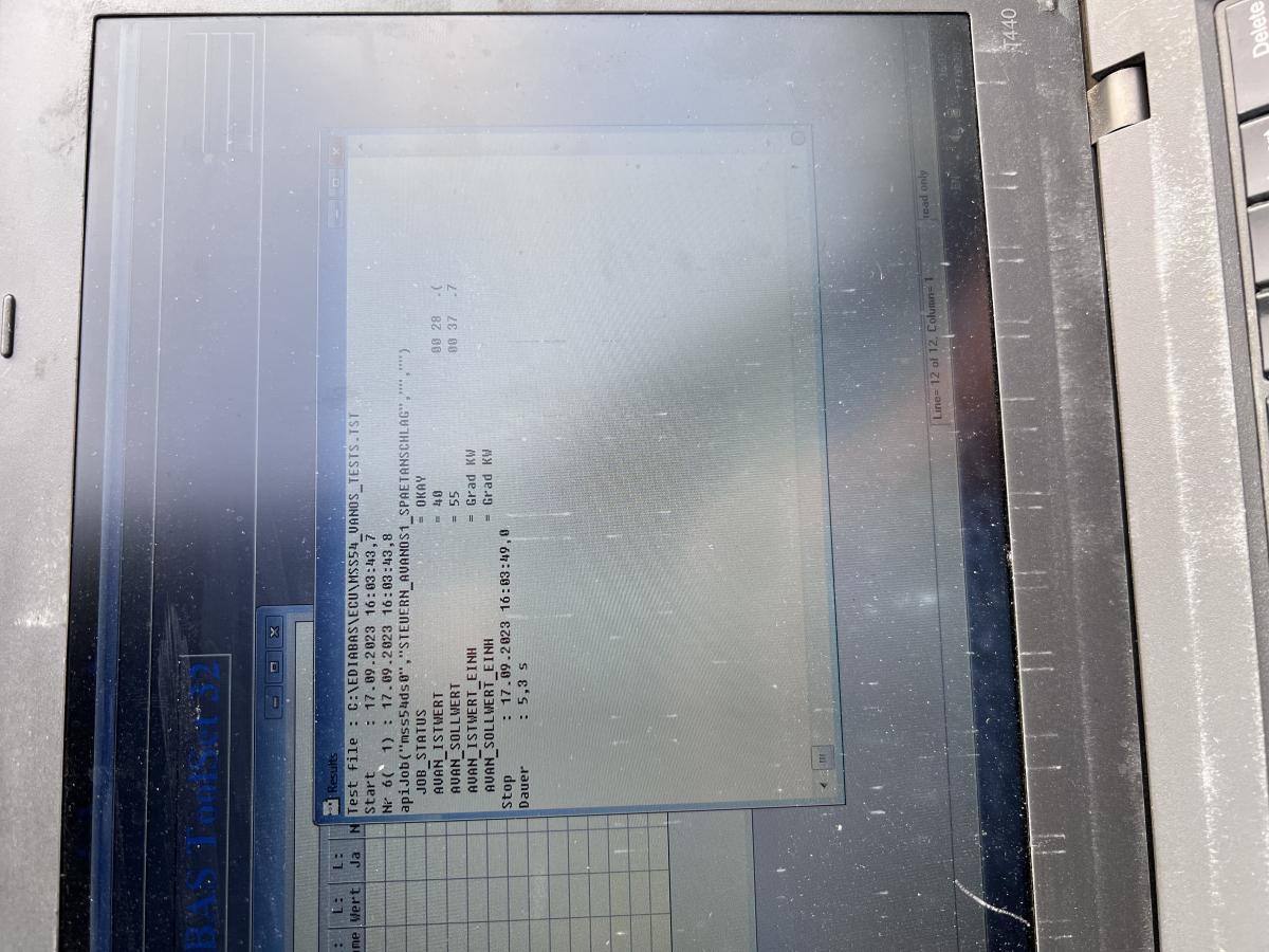

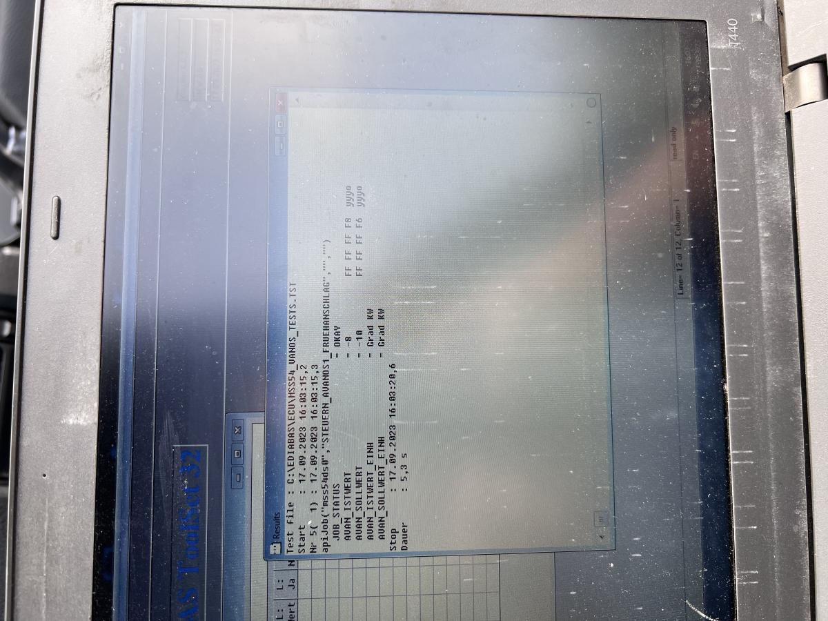

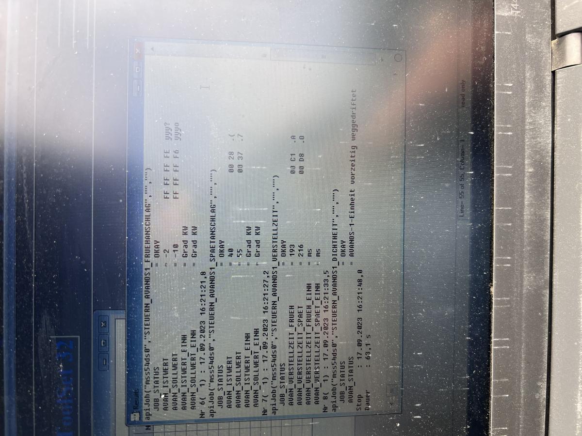

    Need help. Installed schrick cams and beisan seals kit on vanos mechanical part, solenoid pack is untouched. Currently having an issue with exhaus cam. In tool32 vanos test- intake is ok (-1 to 59), exhaust is always in different positions (from -8 to 30 grads starting position, from 33 to 40 grads), so exhaust cam is not reaching target position and not reaching 48 working range. Car is running normal, no codes in ECU memory. What should i do in step by step? First of all- change solenoid pack? Or it could be mechanical issue of wrong timing/rebuilding vanos? No one has encountered a similar situation where the solenoid module does not work but no errors in ECU?

      On one test i saw -8 to 40 working range but it was one of 15. First of all i thought that it could be vanos pressure issue- when i started full test- intake always ok- exhaust cam- low pressure in vanos and it couldnt go to right range- but then i started to test only exhaust cam and results were very different and i think that low pressure is not a problem that i have. Exhaust cam was floating and never shown stable starting and retarding range. So looks very strange- if it mechanical issue- i think it would be "Stable incorrect",

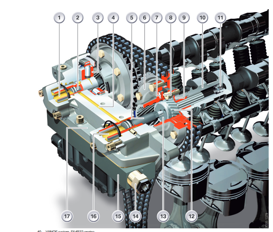

            I also now think of something else, you installed Schrick cams. Did you check if the non-return valves were installed before installation? #11 in the picture below. Sometimes these are not installed from factory.
                Click image for larger version  Name:	S54_VANOS.png Views:	0 Size:	833.4 KB ID:	234417
                I've checked #11 valves because that was the one of main reasons that i've bought schrick cams istead of catcams- valves are on cams 100%
