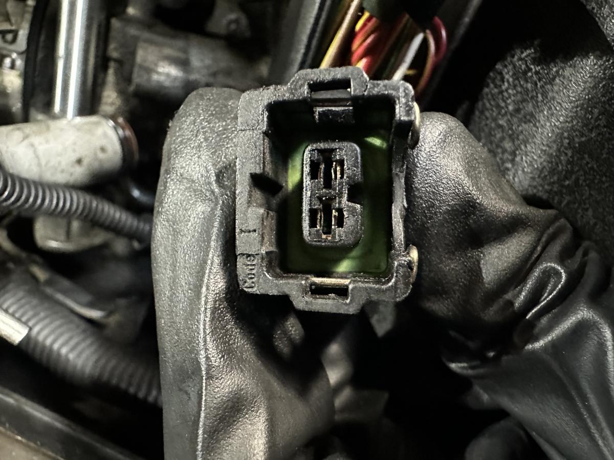

    I just put them back in, install went smoothly, but now the issue is different. Misfires right at startup, even when cold, and now in cyl 6. Wtf.
    I’ve checked the connection between the harness and the injector and it seems to be seated correctly. The only thing I can think of is maybe the harness was damaged when I was removing the injectors. 6 was a bit of a bear to get removed, so maybe I broke it in the process? No obvious signs of damage though. Should I test voltage or something from the harness? I don’t really know how to do that.

        Pulled the injectors again and the harness on 6 is chewed up. Any idea on how easy or difficult it is to fix this?
          First thing I would do is depin the wires and very gently try to tighten up the fit on the injector pins. If that fails to work you could buy a pig tail.

          Or you could buy a new connector and pins and crimp them onto the factory harness. You would need the proper crimper to do that.

            There is probably a repair kit. Or find someone with a crap harness that is willing to cut one off.
