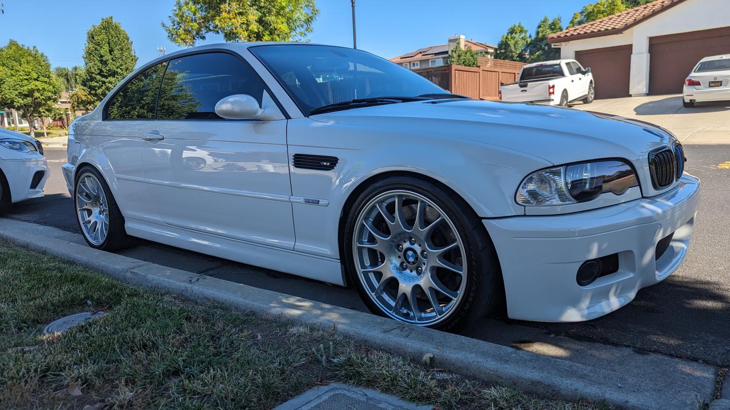

          My bumper has pulled down on the passenger side over time, and I have a nice little half finger gap there now.
          I bought the Trinity bumper mounts to fix it but haven't installed them yet.
          I think I'm personally going to swap to a CSL bumper, so I haven't messed with my euro lately.
          Pic of my gap.
            Pic of my gap.

            I'll have to figure this out on my own, these OEM bumpers don't fit right, sounds like with enough time spent it will indeed fit.
