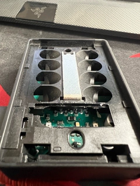

    Hi There - I recently got an error that the rain light sensor module has a fault, pulling out the sensor i quickly noticed that a chip had soldered off and was bouncing around in its casing - I ordered a brand new one from summit - I installed the new unit and now i have a fault saying it has to be coded - i would have though since the car came with the rain sensor from factory, there wouldnt be a need to add the VO, program GM5, etc. has anyone had this issue before? Do i just need to rewrite the program file .MAN with the new sensor plugged in to take effect?

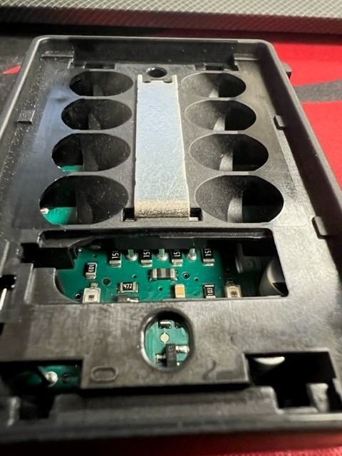

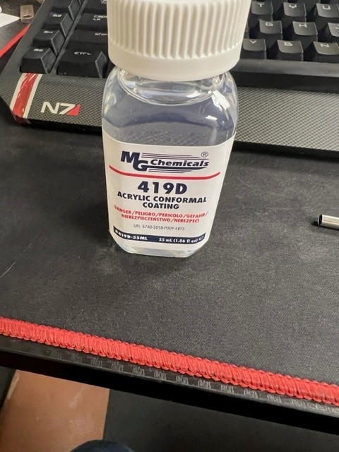

    Additionally i added conformal coating to help protect the PCB board and extend its life. The tiny chips labeled 151 are the ones that fall off. Few pic's:
