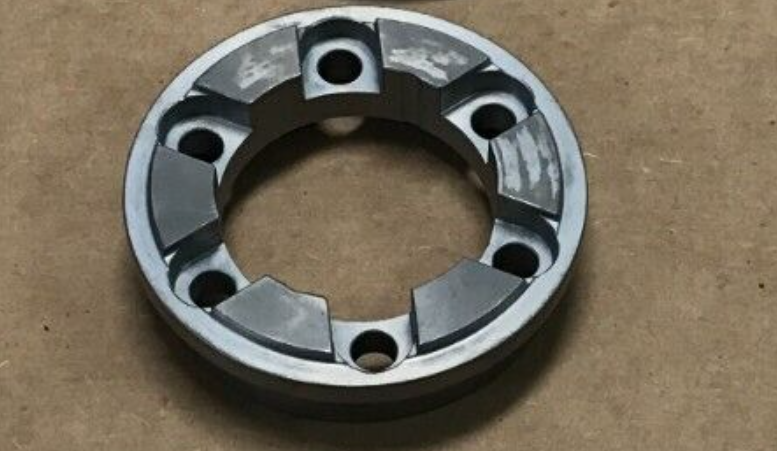

        I am thinking one easy way to keep the bolts from backing out, just like Nyloc nuts: add a section of heat-shrink tube on the bolt near the head as red colored in the pic. The shrink tube will jam the bolts to the spacer holes as Nyloc.
        I will measure the clearance between bolt and hole (which is not threaded). This is easier than cleaning the bolts and threaded holes on the cam and Loctite.

        Spacer alone:

          Does the cam come with the splined sleeve? I can't find the part number for the sleeve and the above spacer on RealOEM.
