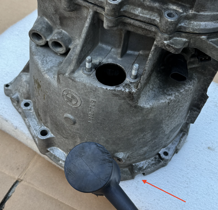

    My apologies for what might seem like a dumb question, but anyone know if it's possible to get a borescope camera in the bell housing of a manual 02' m3? I'm confident a dowel pin came out of my flywheel and I'm trying to see if I can verify before having to pull the trans out
    Pull the slave out?
      I forgot if the 420G has access holes like some transmissions do, but worst case if it doesn't just unbolt the 2 nuts for the clutch slave and use that hole.
        There is an access hole around 7 o'clock you can put a borescope through

          This pic is perfect: I would remove the slave for the borescope to look at the dowel pins from the PP side, and use the said 7 o'clock to turn the FW using a screwdriver, slowly to view all the dowel pins.
