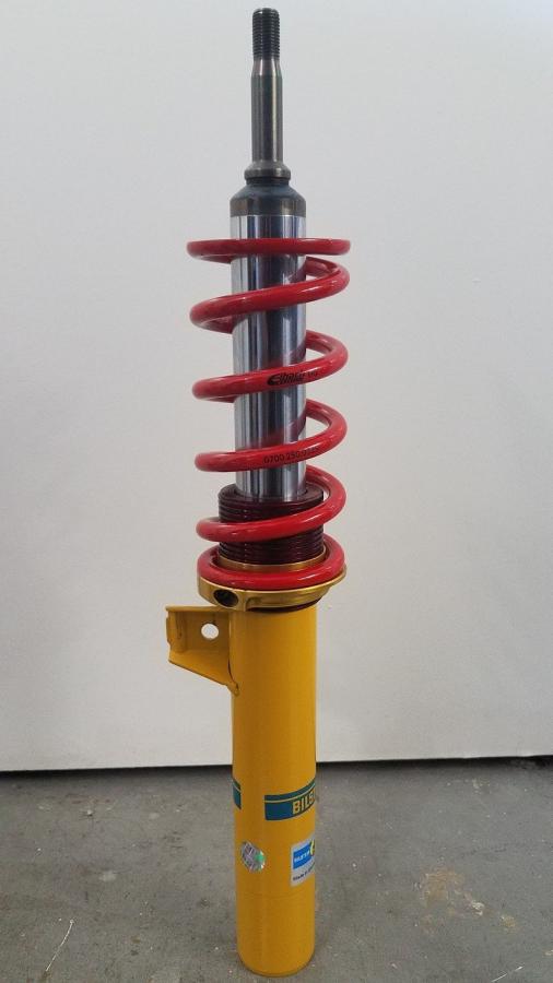

        I really loved my bilstein B6s with GC conversion when I used 325lb 7" front spring (for sale btw ) and 550lb rear. I had TMS front plates which gave back about 5/8" travel, and "tall" GC rsms. I ran them at 13.6" front & 13.25" rear. I also trimmed the internal billy bump stop a little.
          Pics

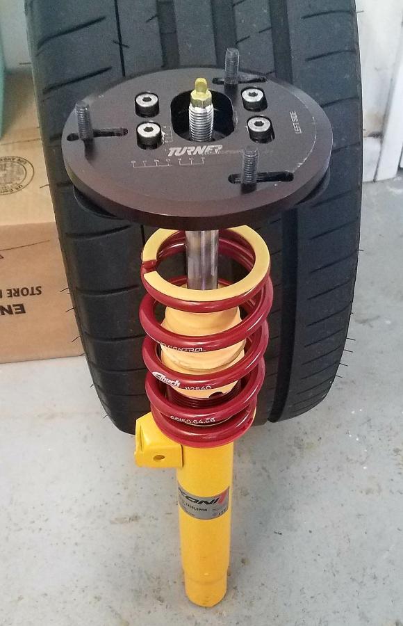

          koni on the left, then modified to fit bilstein b6 (right)
