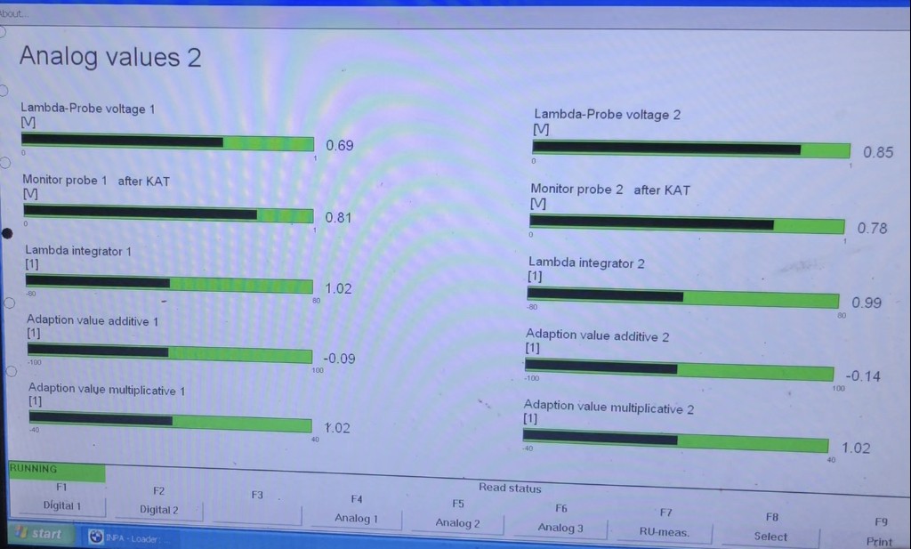

So exhaust has funky smell, car drives like it has a potatoe stuck in the exhaust and inpa shows pre and post cat voltage are in sync……it’s safe to assume my cats are bad.

car gas not been driven in 10 years and I have a strong suspicion bmw or previous owner messed with the software /coding to somehow disable the catalyst Cel or had some funky tune on it . Any way to check this on bmw scanner , inpa , fpk etc ? The emissions communication recall shows done on service history and bmw scanner shows software version to be post recall as well.
