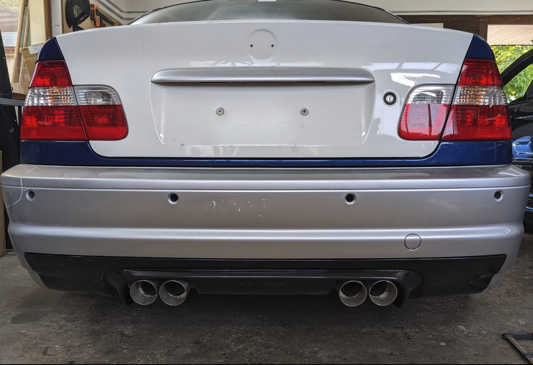

    I picked up a CSL section 3 but it's missing the tips, was hoping to find some replacement tips that were a little bit bigger than the factory tips but had the same OEM look and still would bolt on with rivets like the factory tips.

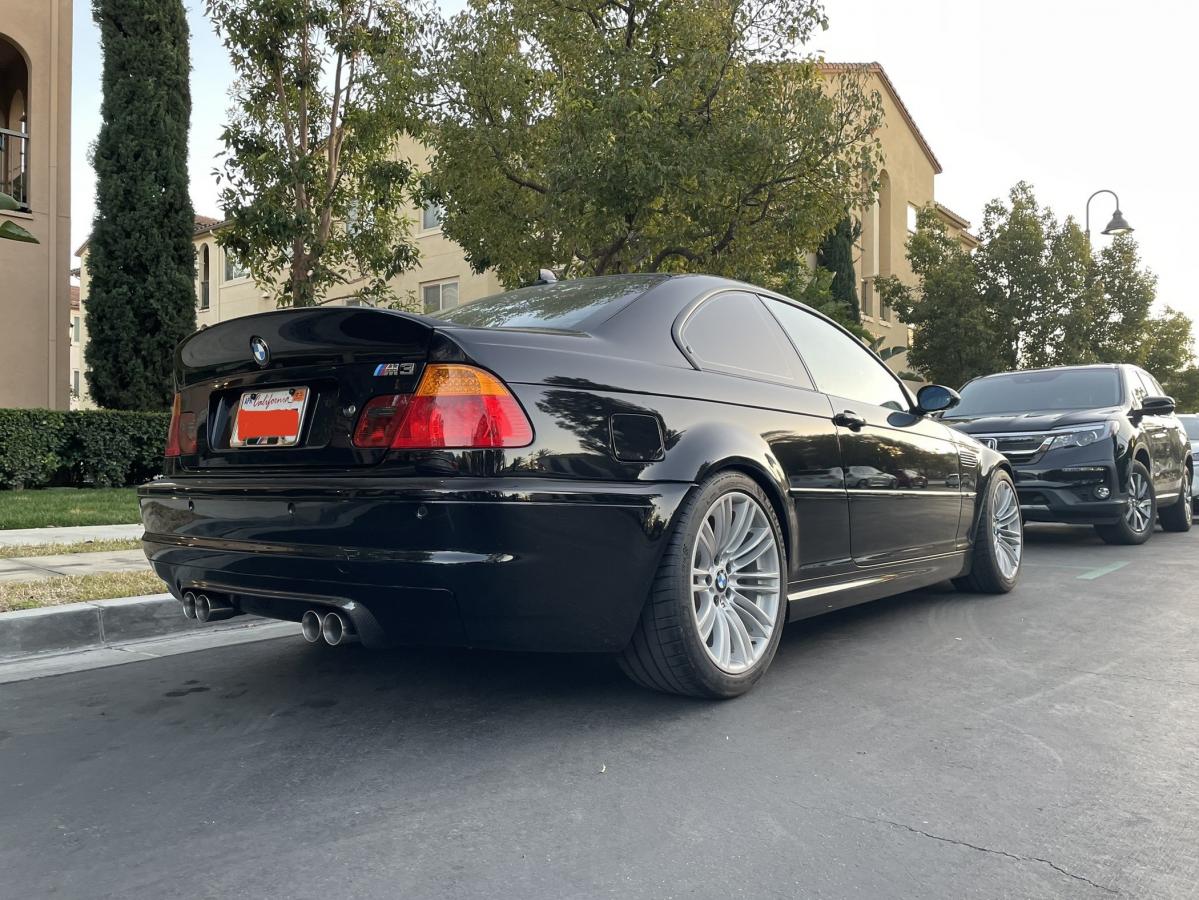

          This is what I had on mine: https://www.ebay.com/itm/26292809140...Bk9SR4qWxvT5Yg
          I liked them a lot - fitment was good, finish was decent and size is just right IMO. No close up pics of the exhaust but here's what they looked like on my car: https://nam3forum.com/forums/forum/m...eur-photoshoot
            Yeah I did see those, how confident are you with the tightening mechanism that he uses with those tips or did you get them welded on
              Installed as-is using the clamps. It took some fine adjustments to get them perfectly staggered like the OEM pieces but once installed, they did not budge in over 5 years and many miles.

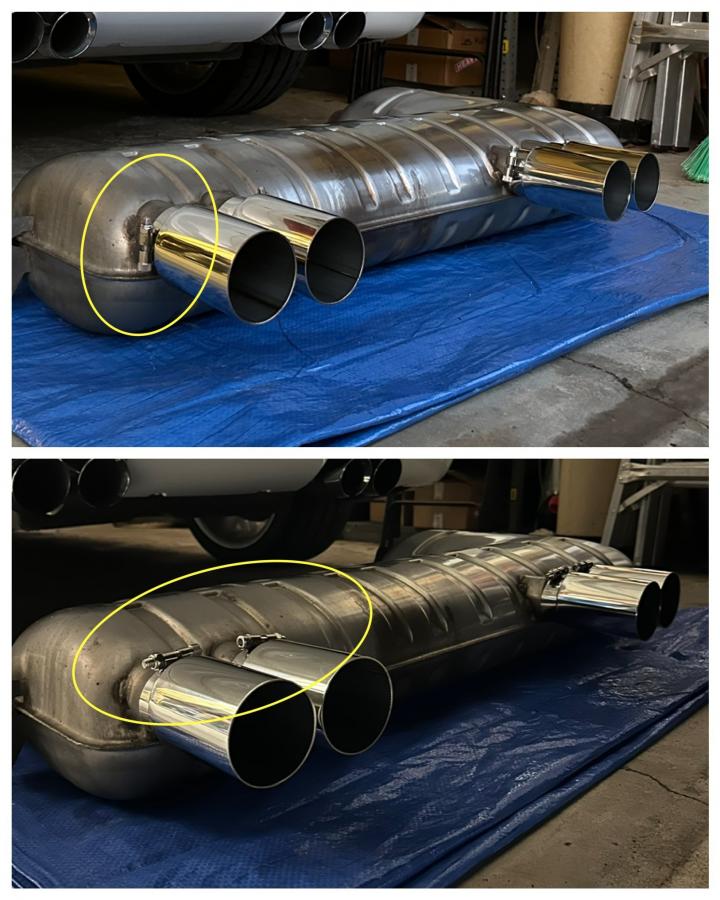

                        If you install those jgm12507 eBay tips, it’s worth nothing that you can adjust how close the tips are to each other by twisting the tip.
                        I originally thought my factory tips were bent and the aftermarket tips would not fit. I reached out to the maker (spoke over the phone) and he confirmed the tips are designed to be adjustable in relation to one another. By simple rotating the tip, you can create a gap up to 10MM. I had the fastener for the tips at the 6 o’clock position for both tip and they were super tight - basically touching eachother, and I couldn’t get both tips on at the same time. I rotated the tips so the fastener was at the 3 o’clock position on one tip and 9 o’clock position on the other tip and it create a nice, factory style gap.

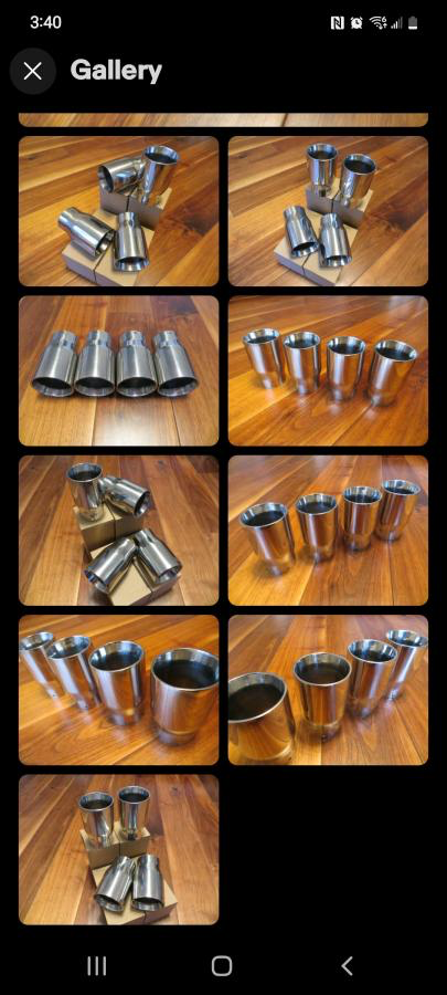

                          Click image for larger version  Name:	IMG_1106.jpg Views:	0 Size:	192.3 KB ID:	243783 Click image for larger version  Name:	IMG_3438.png Views:	0 Size:	492.5 KB ID:	243782 I bought mine from a guy on here who happened to have got some of the last sets when someone from Europe was making the Euro 76mm double walled stainless steel tips.
                          I sold my RE El Diablo and then got a stock section 3 and just popped the rivets off the stock ones and put new rivets for these. Fitment was pretty good I’d say! (Also, yes my M3 badge on my Karbonius CSL trunk is not placed correctly 😂)
