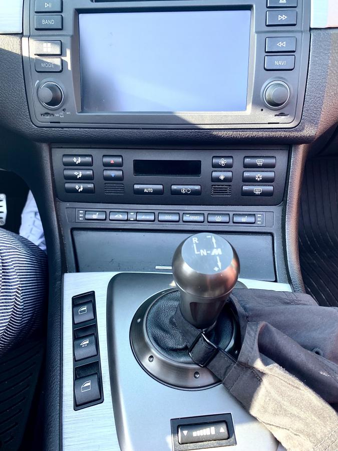

        I'm also one for stock look and feel, just not stock sound. Like I said, it was "hopeless."
        FWIW, "all out" was less than $2500 for me and looks as pictured, but sounds like the band is in the back seat top down at highway speeds. I've owned it for over 12 years, have no intention of selling it. We don't use it much, but when we're in it (me and/or the kids), we're typically on vacation and need to enjoy it. I own a few of these older German "classics", so I always end up thinking too hard about bringing the sound system modern without it looking kraykray.
        The BavSound speakers are invisible, the BSW Sub is invisible (but NLA) and the head unit looks "stock enough" that people don't know the difference. "Stock sound system?" is a question I often get from passengers.
        For your case, just do the speakers and judge from there how far you go. I did the speakers first which was 75% of the benefit, but that included the Bavarian Sound Works (BSW, BavSound predecessor) subwoofer, which they stopped making. Everything else was chasing that last 25%, which required a separate subwoofer channel, etc. 12 years later, that + the sound deadener in the doors and floors is some of the best money I've spent on the car -- you hear the S54 OUTSIDE, not inside the cabin.
