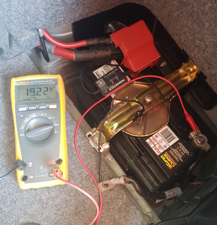

                      Yep. definitely 19mA. Spec is <40mA so you might be close to the limit but definitely give it chance to sleep. The onyl additional load in mine is a BlueBus which I would expect to be very small when asleep. Note the Powertech (BM2 battery monitor) is directly across the battery so not included.
                      As for the time I waited, I can't be sure sorry. I just set car up, trigger boot latch (so it thinks boot was closed), lock/arm car with remote and walked away. Was probably around 20-30 minutes at a guess. I seem to remember it actually goes to sleep quite a bit quicker than they say though.
                      NB: You have to be very careful it does not wake up if running on a 400mA range DMM. It will blow the fuse instantly if anything comes on like interior light etc. Even 10A range will be an issue. I started on 10A and then by shorting out the circuit moved down to the 400mA. You cannot break the circuit at any time. As soon as you reconnect, a lot of stuff will wake up and take out the fuse.
                      from my post on m3cutters:
                      Ok because it interests me and it's good to have a point of reference if I'm ever tracking something down, I measured with a series DMM.
                      1) Put car to sleep as above with boot open and latch triggered so car thinks it's shut.
                      2) Connect DMM on current range (I started on 10A) between -ve terminal and battery clamp which is solidly connected to vehicle
                      3) Disconnect -ve cable from body
                      On the 10A range it read about 21mA. So I decided to move it to the 400mA range very carefully.
                      4) Put a shorting link across DMM terminals (so current not running through DMM)
                      5) Change DMM to mA range (probably important to do this first as internally the DMM may not provide a current path unless on the 400mA range, 10A range is usually always straight through)
                      6) Move connection from 10A to 400mA terminal
                      7) Remove shorting link
                      It sat around 18mA jumping to 19 semi frequently.
                      Only modifications to the car that might draw any extra current are a BlueBus. I expect Ted's done a pretty good job of making it low power so maybe 1mA ar so. The battery monitor you see is not being measured by the DMM.
