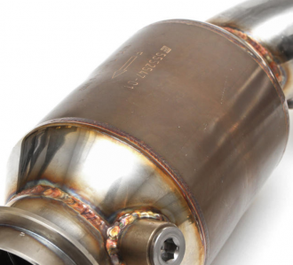

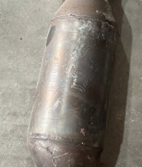

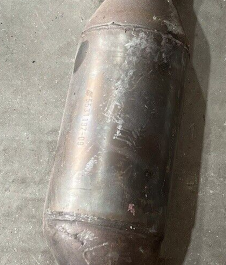

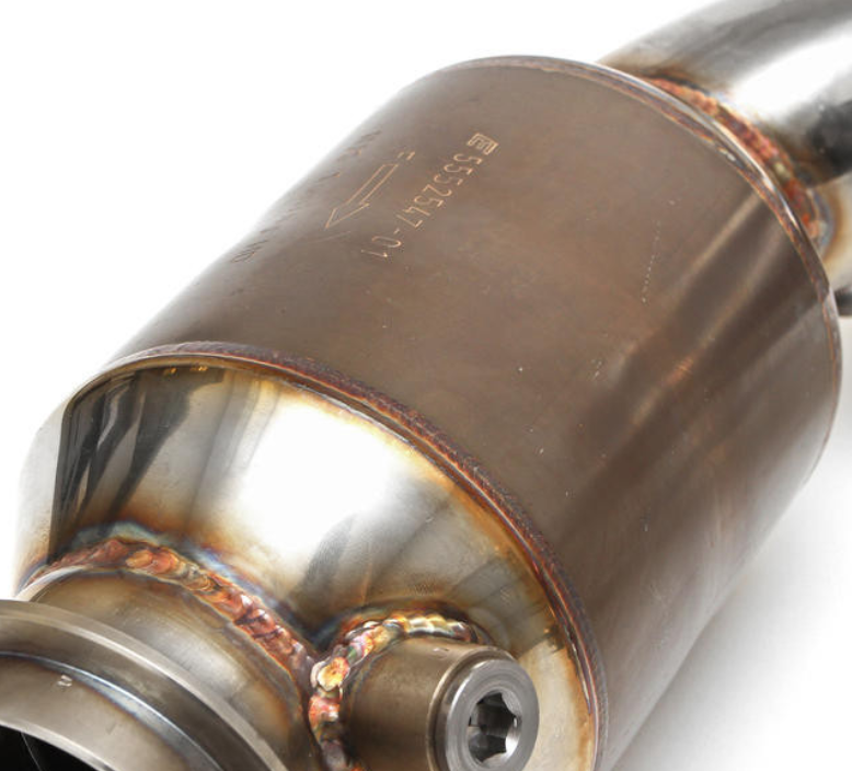

                          According to this - http://www.unofficialbmw.com/images/...ust_System.pdf​ & this https://hjs-motorsport.de/en/product...quality-check#, the stock equipment is made by EMITEC who also supply HJS. Both are stamped with an HJS serial number.
                          Click image for larger version  Name:	m3.png Views:	0 Size:	788.7 KB ID:	245439 Click image for larger version  Name:	hjs.png Views:	0 Size:	503.3 KB ID:	245440
