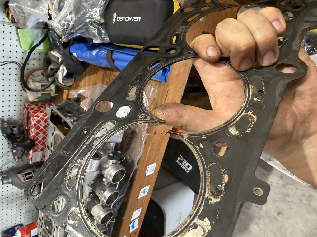

    UPDATE 05.05.2025
    Finally pulled the head off last week. I wasn't driving the vehicle for over 1 year because suspected the head gasket fail. Good thing I didn't. Failed between cyl 5 and 6. Apparently I caught it very early thanks to the compression check and audible ping I heard couple of times and never drove the vehicle after that.

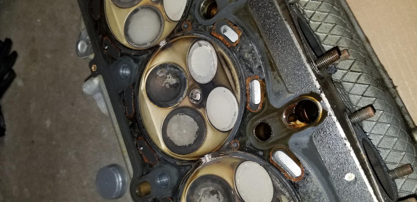

      When my head gasket failed @112k miles (had the ticking/rattling sound under load) my numbers where:
      • Cyl 1 - 160
      • Cyl 2 - 155
      • Cyl 3 - 165
      • Cyl 4 - 125
      • Cyl 5 - 110
      • Cyl 6 - 165
      I'll find pictures of the burn through and attach them below.
