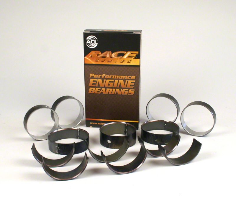

I would probably go with ACL but standard or extra clearance (probably extra)?
Standard:
https://www.ecstuning.com/b-automoti...39-slash-40~a/
Extra Clearance:
https://www.ecstuning.com/b-automoti.../6b1569hx~acb/
Cheapest I could find for the extra clearance:
ACL Throtl BMW S54B32 0.025mm Oversized High Performance Rod Bearing Set - 6B1569H-.025 6B1569H-.025FREE SHIPPING! Whether its for a full rebuild or some standard maintenance, the proper engine components are needed to make sure your vehicle is running smooth.Last edited by 0-60motorsports; 12-10-2023, 01:02 AM.
