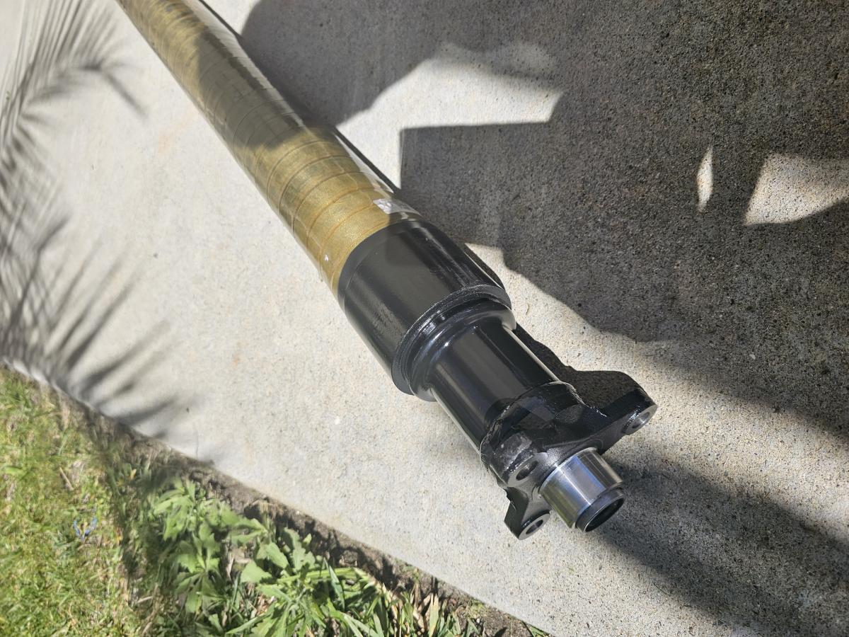

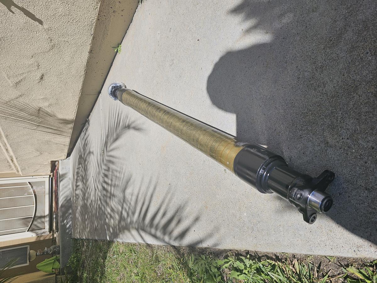

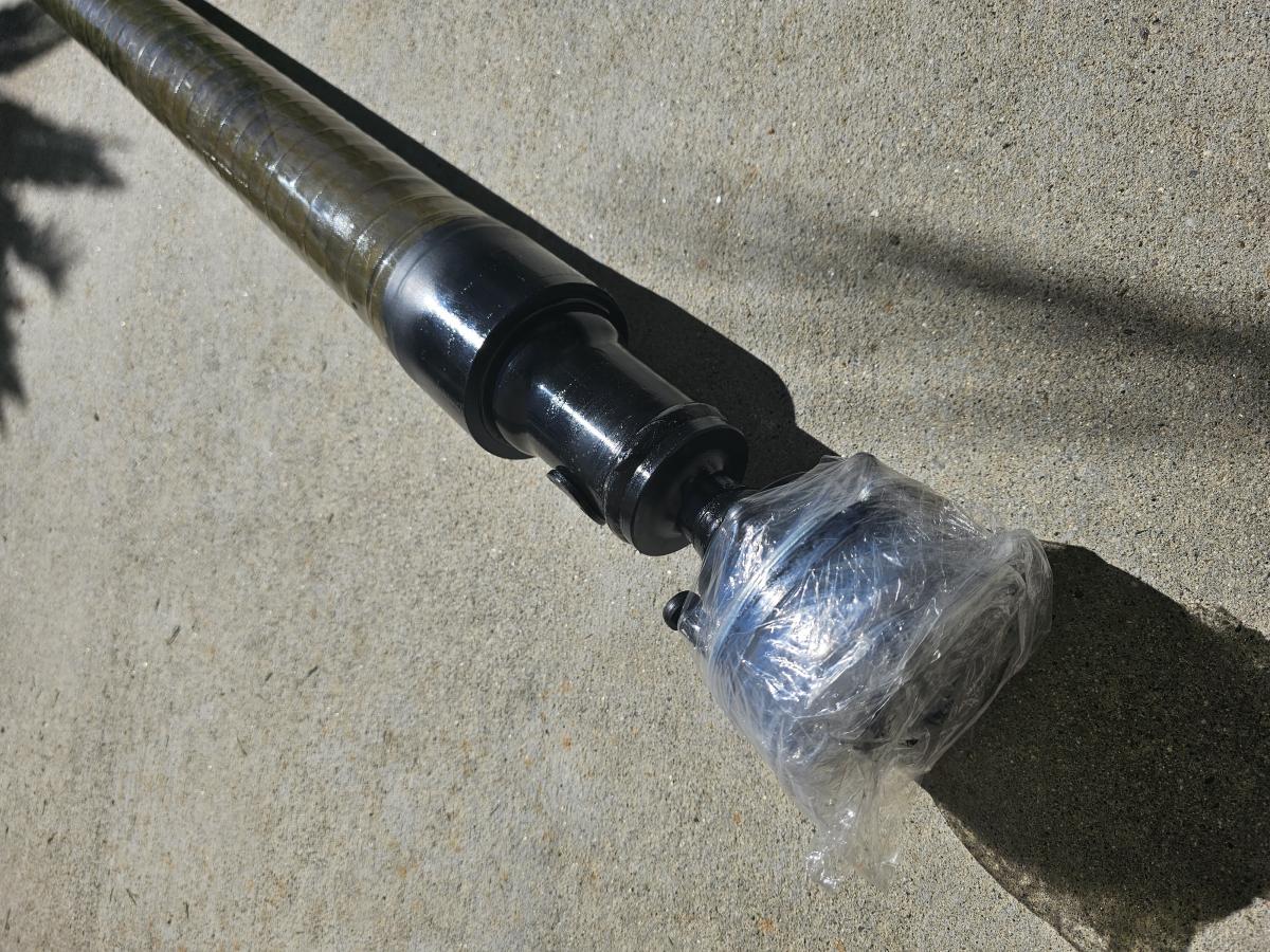

    There you have it. My driveshaft was done improperly. Now I have to figure out why.
    I was wondering why your shop welded a new tri-flange to your DS. IMO when going that route they should've at least used the output flange from your transmission to ensure the DS centerline stays aligned with the transmission output shaft centerline.

    I checked with my local shop, they said no problem. But, I'll have to exchange it for another since the side of mines looks slightly damaged. They said about the same cost as the other invoice placed here a few pages back. I don't want to release shop but apparently according to the shop that I take my car to claimed they're the 'best' around here.
    I'll test and see how the results are.
