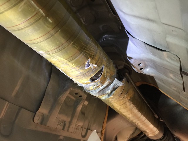

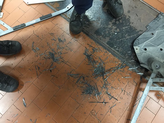

    Interesting.
    Back in 2015, S55's were snapping these things so BMW went back to metal driveshafts lol.
    I took my DSS CF one out because it wasn't balanced correct, if anyone has this finally installed, I'd like to know who you used and if they would do it for all of us.
    IIRC there was a recall on those.
    I might do this for my E9X M3. I have an account with a rebuilder. Not sure if this is their thing but I'll have to ask. This place will turn around a metal DS overnight so they should be relatively quick.
