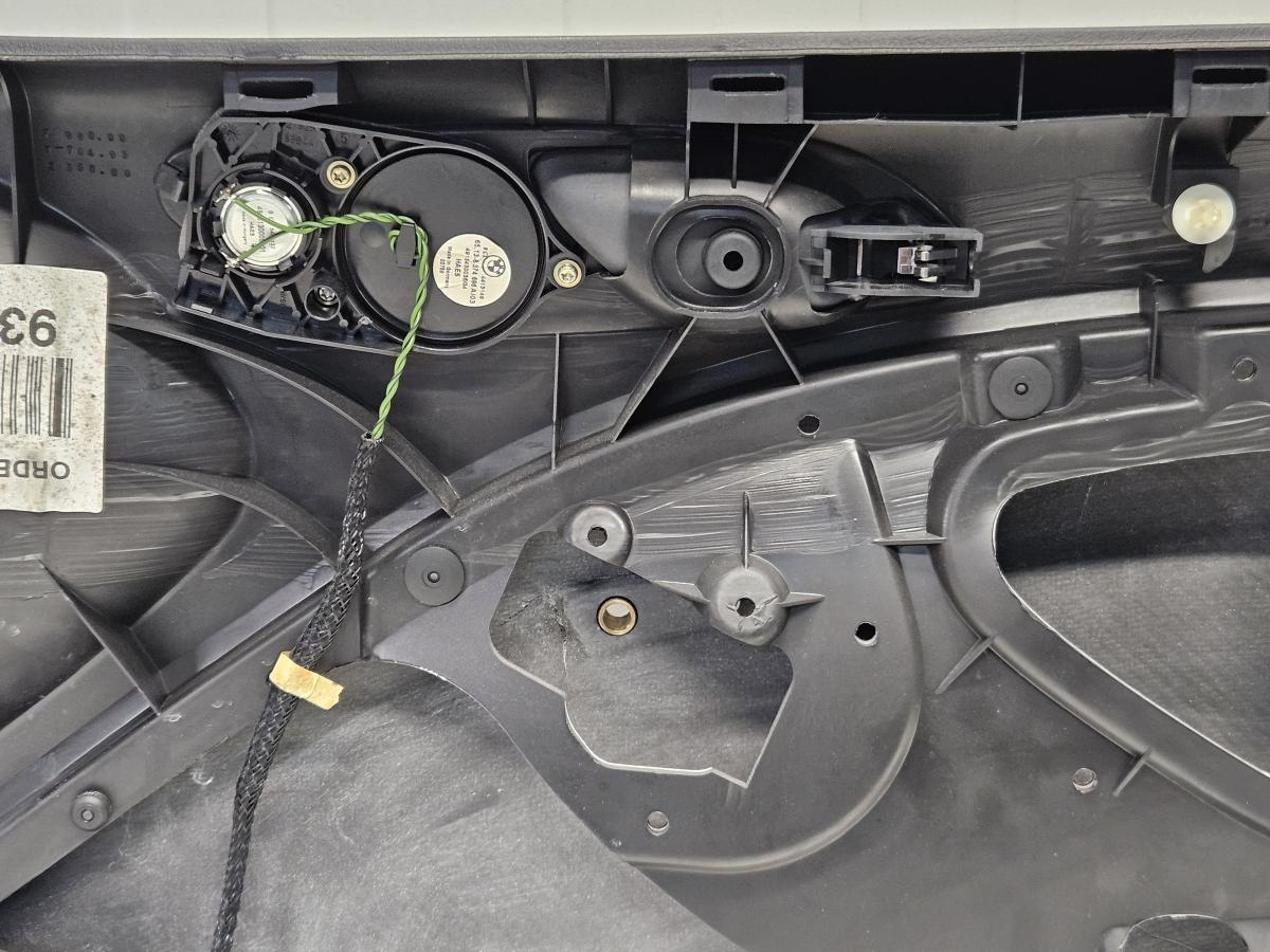

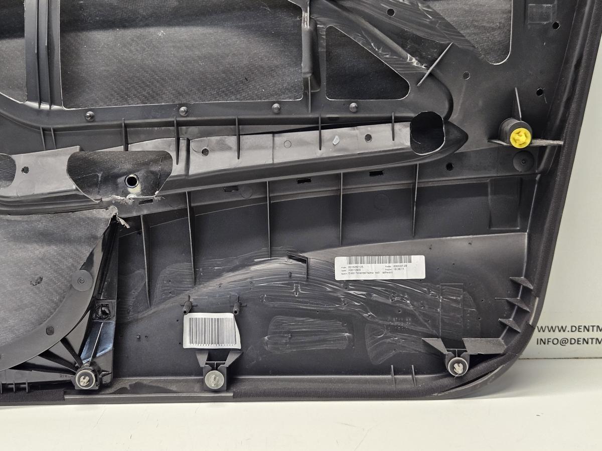

                  Original CSL doors use rivnuts for the brackets, this might seem insignificant, but this allows for the brackets to be installed on top of the vapor barrier, so you do not have to cut it, this is significant as the vapor barrier kind of needs to be 100% sealed to work. Door panels and water do not mix, causes mold.
                  And here is some pictures of original CSL door panels, how BMW made the holes, for documentation sake.
