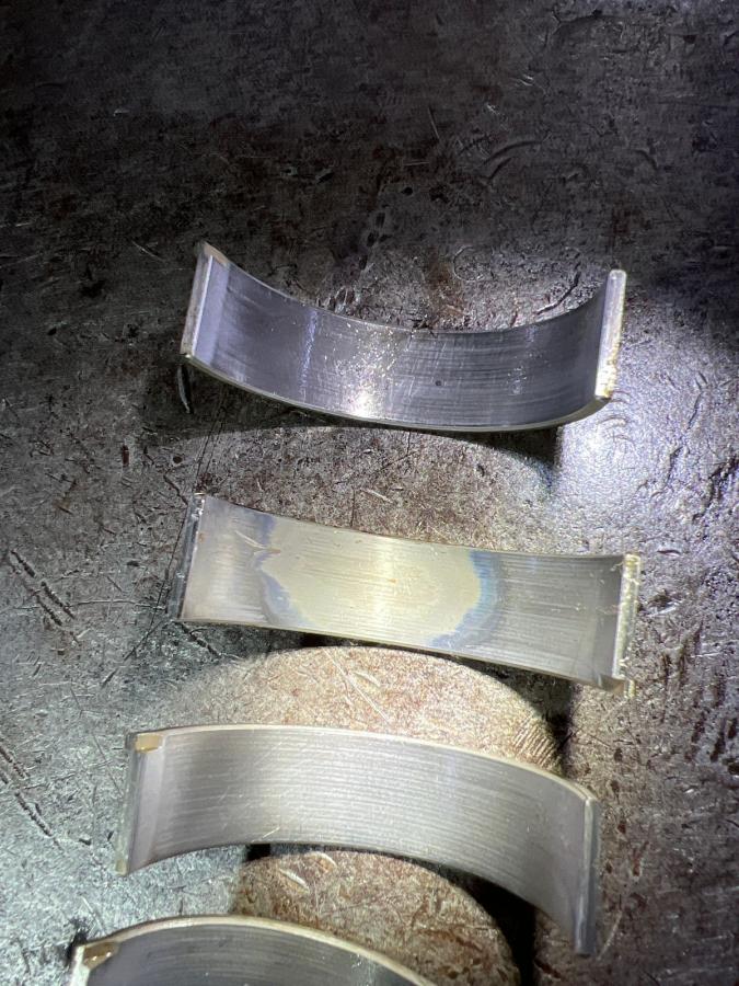

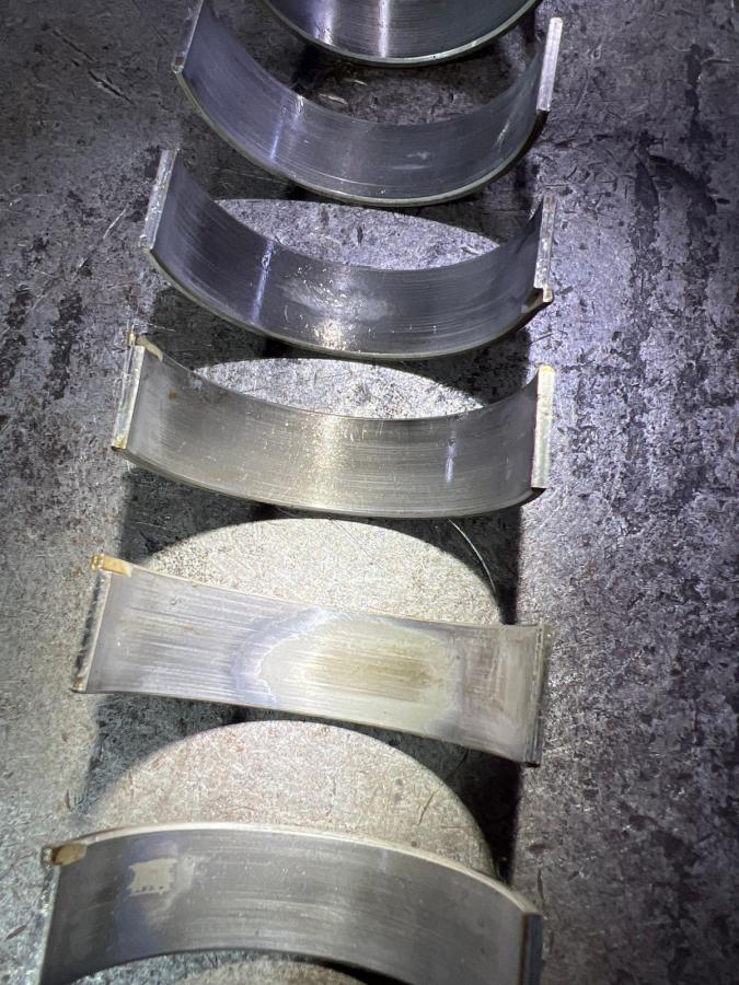

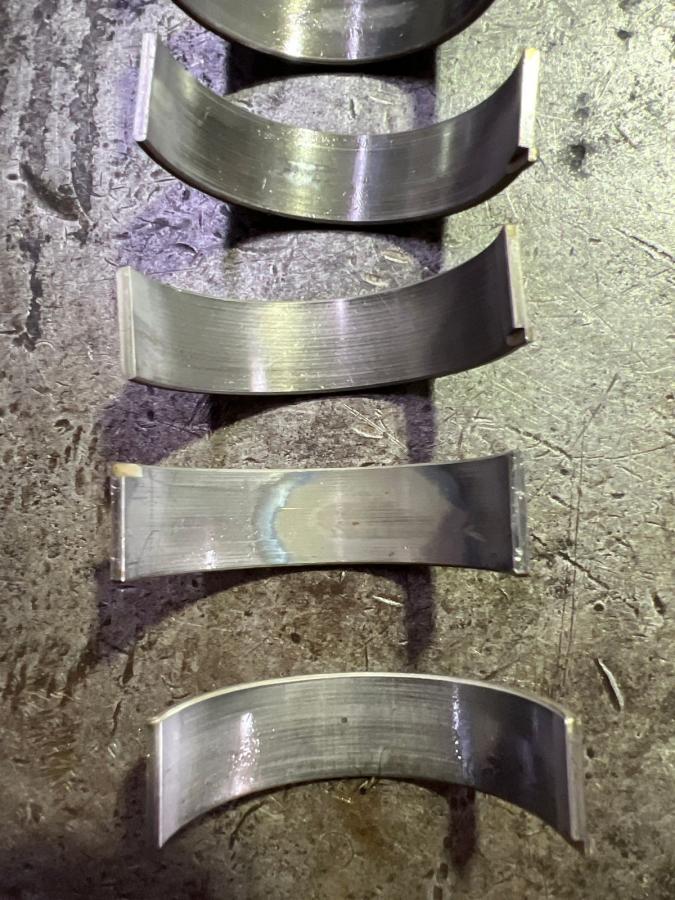

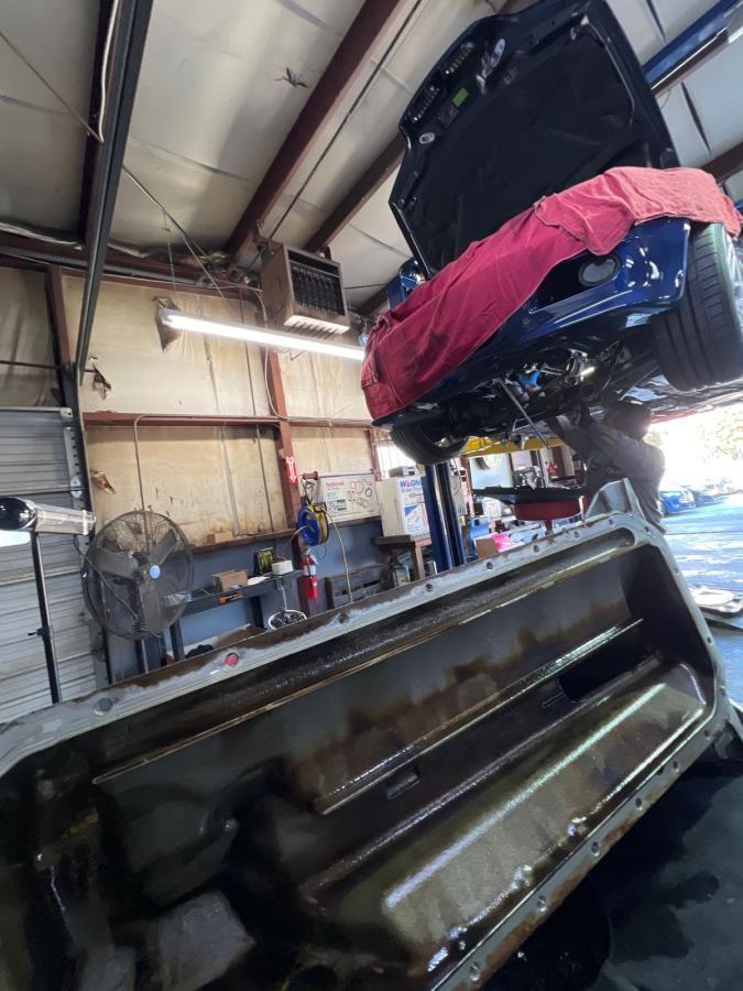

    I had my rod bearings replaced this week using BE Clevite bearings and BMW OEM bolts. My car is a 2005 Competition with 51k miles. Many of the rod bearing pictures I see are cars with 100k+ miles, so I wanted to share my results to give folks a view of what to expect from a lower mileage engine.
    I bought this car with 50k miles and the Vanos + Subframe mounts done, but no record of Rod Bearings. I didn't have any records of how the car was driven by previous owners, and being that I imported it from Canada I wanted to make sure it didn't have extra wear from hard drives when the oil is still viscous. I didn't expect copper to be showing....this was more of a peace of mind project because I expect to keep the car for life.
    Below are the results. As you can see, I had 5 pieces with a bit of wear. It's not something I'd describe as excessive; however, with another 50k miles, I'd expect them to probably be near replacement time.
    Anyway, just sharing to give another perspective on bearing life from a lower mileage car versus the ones you see with 190k miles and have almost worn through the copper. Interested if anyone else has any observations.

    That looks about right. They probably had a good amount of life left in them. At 100k mine were just showing copper.
    BTW there is a rod bearing thread, located here: https://nam3forum.com/forums/forum/m...howcase-thread
      I'll be doing mine this year with the WPC OE bearings and OE rods. I just hit 55k. I'm curious to see mine, not sure if being boosted it's entire life has caused increased wear. Both times I've gotten the oil changed I forgot to bring the container to have the oil analyzed, so I have no idea what to expect. I would assume my car has a harder life than most being an S3-R
