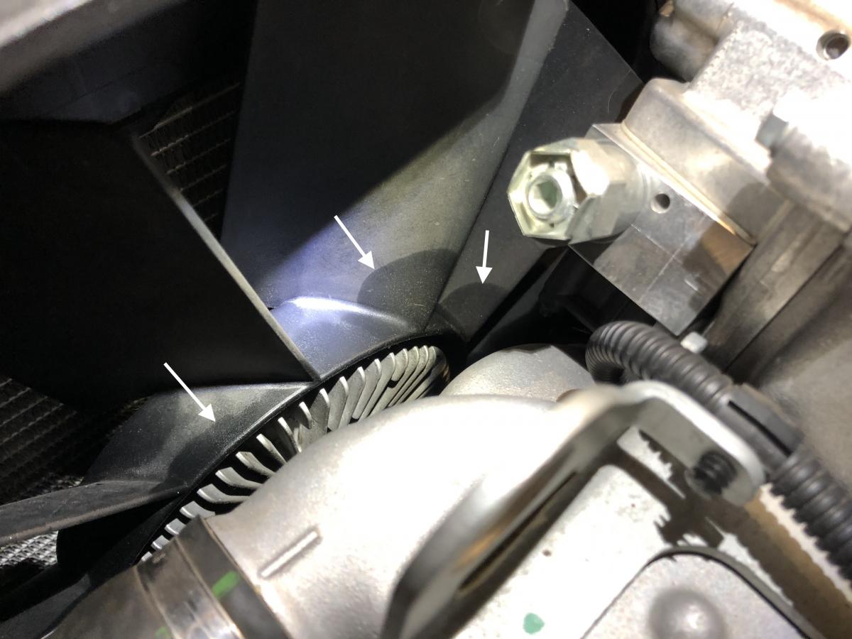

                I did notice today what appears to be an oil residue around the fan circumference suggesting some sort of "leaking" from the fan clutch as shown below. Is this indicative of a failure? With engine off, the fan spins by hand, but it's by no means "loose" in that it REALLY spins with minimal input.

                  End of life approaching for the fan clutch, not expensive to replace so I recommend you go ahead and do that.
