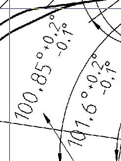

    I’m pretty sure it ended up being a degree of extra camber, but I don’t know if the documentation of that ended up making it to the new forum.
    In essence, it essentially compensates from the increased camber you normally get from reducing the ride height. And doesn’t adversely impact the steering inclination angle as camber plates might.

      M3 an M3 CSL upright difference (camber angle). this is from bmw drawings.
