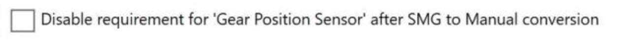

    The one thing i felt it should be ticked is the "Disable requirement for GPS after SMG to Manual conversion?
      you need the option DISABLE REQUIREMENT FOR GEAR POSITION SENSOR checked in conjunction with the other option in the other page that says CLUTCH WIRED DIRECTLY and you need to make sure you are using either black or brown clutch switch that has part number ending in 700

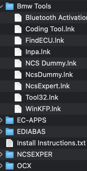

        I have the BMW tools software from EcuWorx since before.
        What HexEditor do i need? Or can i just read the DME with WinKFP and send it to anyone who can check it? I dont really feel comfortable to change and mess things up

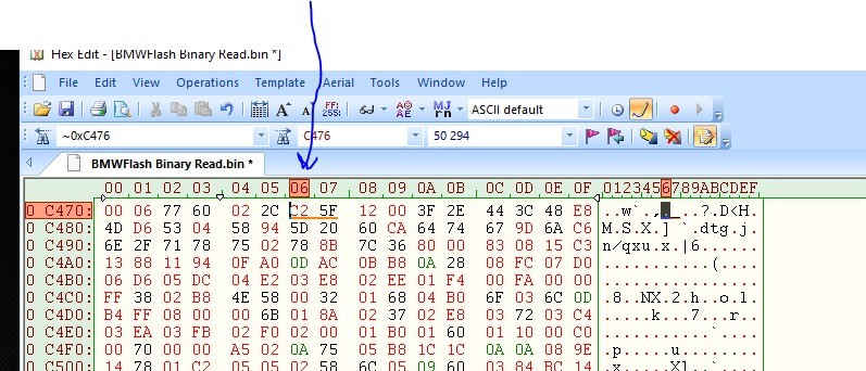

          Hi, im looking at the Binary read in Hex Edit from earlier but i cant even find "Pressure scaling: at 0xC476 change "D3 1C" to "C2 5F" Dont really know how to search for it. Any tips? ​Like on the picture?
            If that screenshot is from your computer showing your tune file then you did it right. You found the right address and it looks like it's already set to c2 5f
            So if that's the case, the code is correct in your tune file.

              Actually it was not C2 5F before, i changed it for the screenshot 😀. But a little scared to write into DME not knowing if i screw things up?

                Original readout it was "D3 1C" no clue at all what that means.

                  This does not make sense. You had D3 1C originally? If so then it is correct.

                    He has a non HP DME converted to HP DME believe. D3 1C is the Non HP internal bar sensor scaling and it needs to be changed to c2 5F scaling for HP tunes.

                      I know, but he said he couldn't find the D31C but then said it had D31C originally.
                      I meant what he did was correct.
                        Yes, D3 1C is in the DME now - mine DME was a NON HP before..
