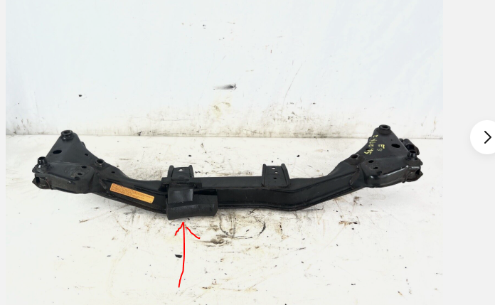

Front subframe cross member with stop-buffer

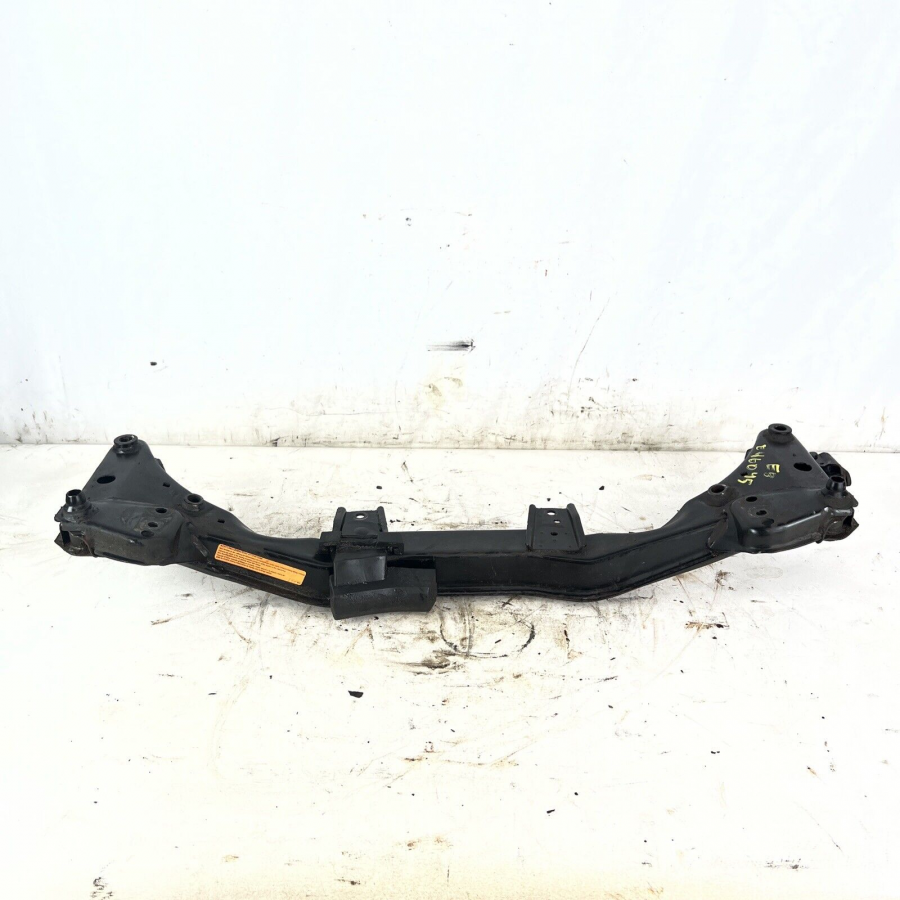

    The E46 M3 doesn't have this but all Z4 S54 and and other non-M cars all have this part.
    Interesting that only the left side has the buffer, and I believe it's to prevent the oil pan from hitting the subframe moving forward during hard braking. Wonder why our M3 don't have this piece.
    I'm removing the 325i transmission to swap out the torque converter, and I think the tranny/engine can be tilted down further (to acess the tranny top bolts) with this buffer removed.

    I'm using 325 subframe with my S54 swap and I have that buffer..I tilted my S54 all the way back when doing the gps sensor change and my engine didn't seem affected by that buffer when tilting back/down
      It's good to know. Btw, the same subframe cross member is used for all E46 non-M and M cars, except some don't have the stop buffer.
