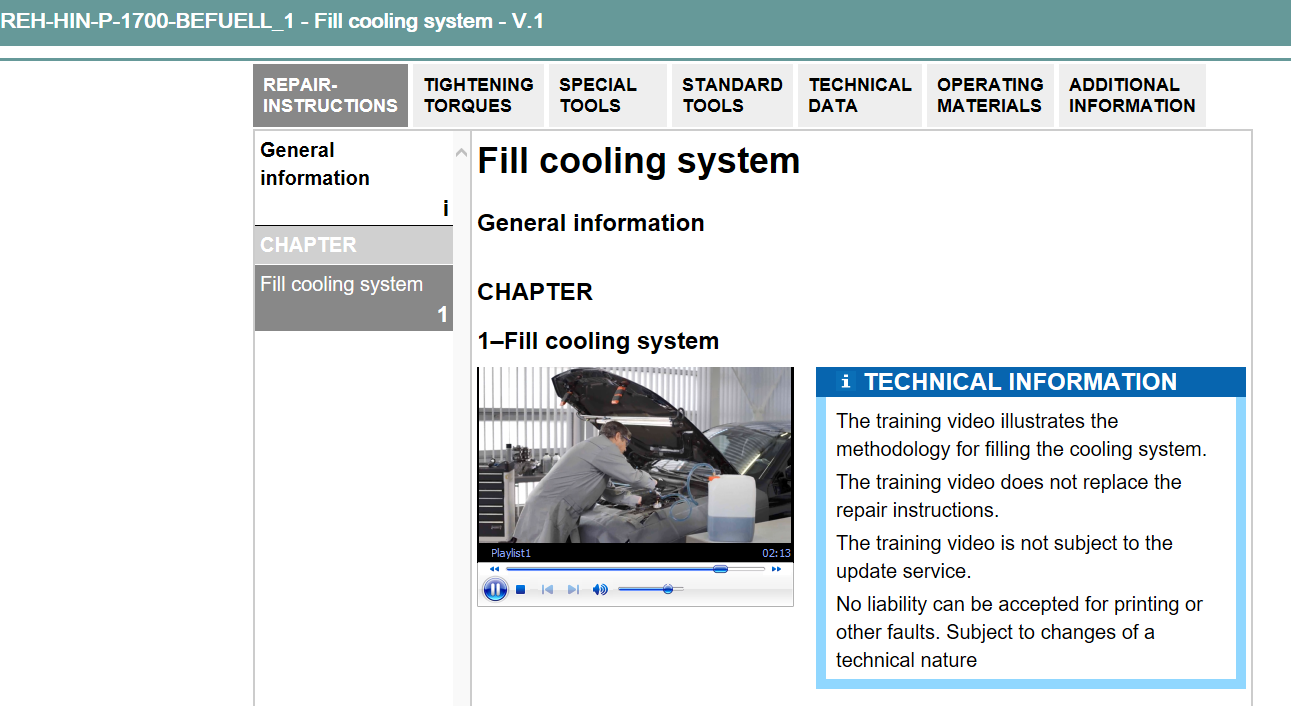

                There is a video in ISTA where the tech hooks that machine up, sorta where i got the shop vac idea from
                Click image for larger version  Name:	Vide.png Views:	0 Size:	188.6 KB ID:	280696​
