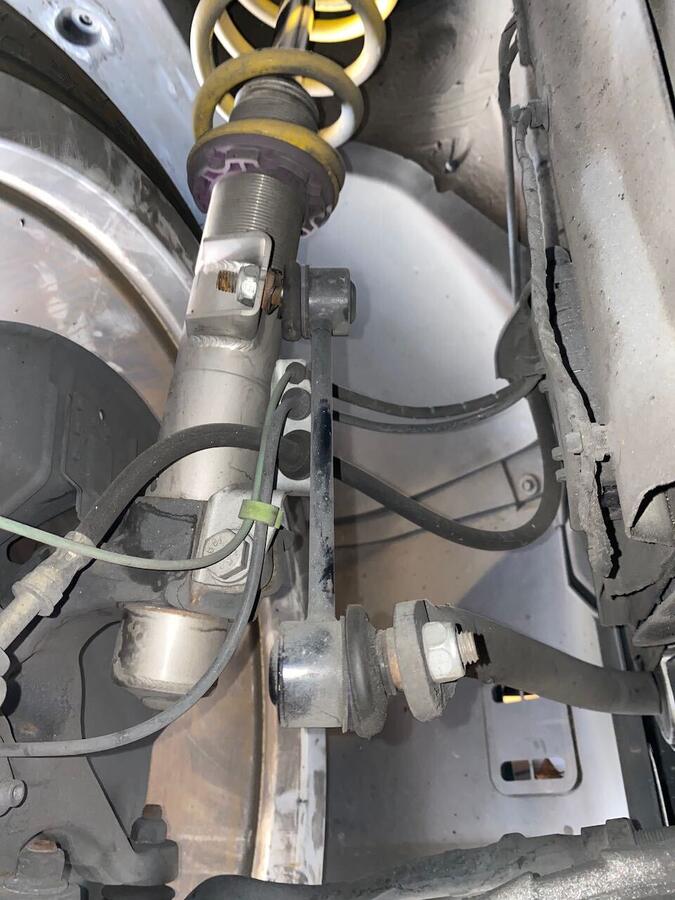

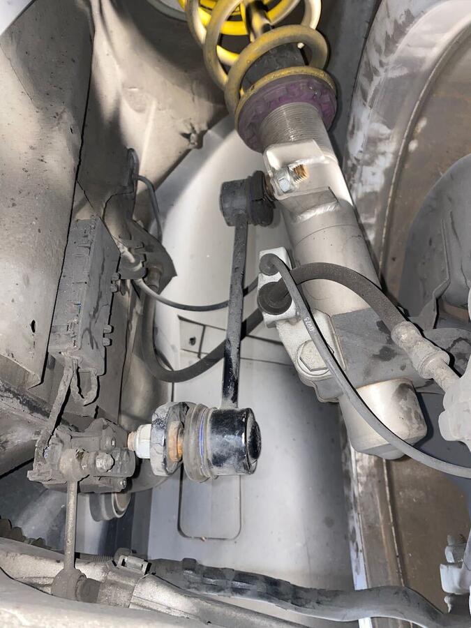

    I'm very sure my front end links are shot (photos attached, lol) but since the car's running KWs I've realized I can't use stock end links. KW sells their short end links for this application but they're $36 each and look like they're just repackaged Meyle HDs. They must have switched because the ones on my car are not Meyle, maybe because of all the cases of them failing prematurely I found online.
    Does anyone know offhand how long they have to be? I've seen 175 to 185 mm reported online, but I didn't think to measure them while I had the car on the lift. More importantly, does anyone know of the Meyle part number so I can just buy HD links?

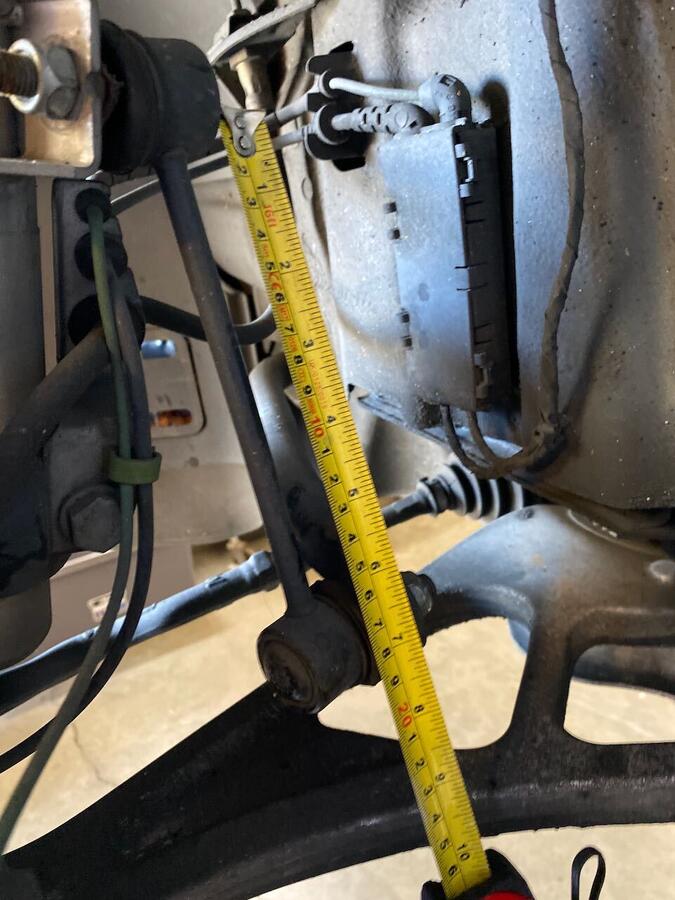

                I have KW V1s that came with the Meyle endlinks, I can see about measuring them later today if you’d like.
                If you happen to be under the car that would be great! I think I'm putting my car back up on the lift today anyway, if I do I'll post here with the measurement.
                  Confirmed it's 180 mm. Going to order the Moog part and I'll report back on how it goes.
