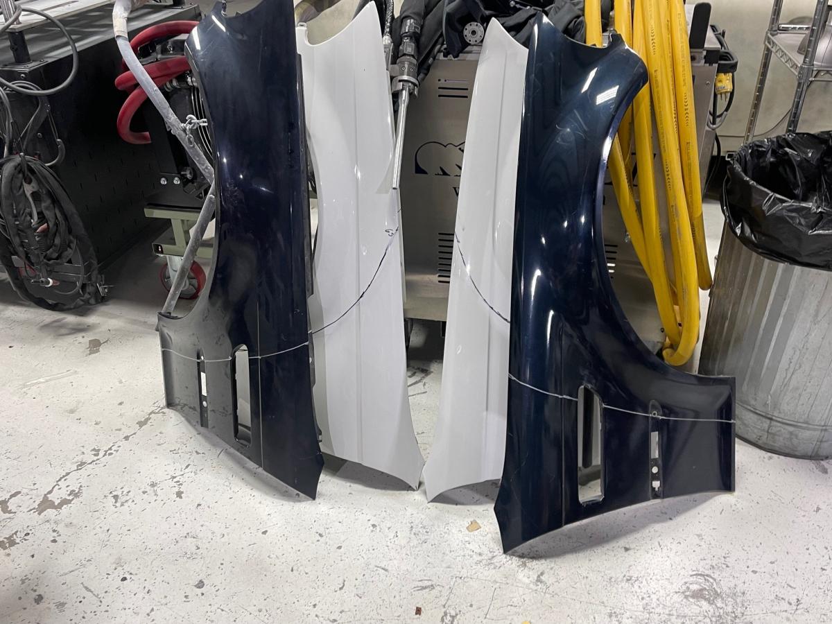

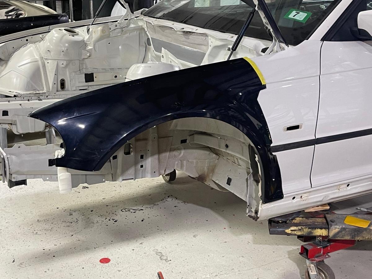

    PS - here's a couple of pictures of the M3 & Touring front fenders with the cut lines and then the fenders trial fit on the shell.
