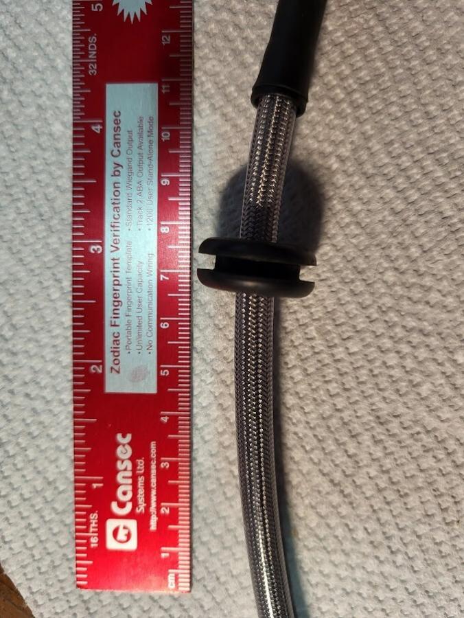

    I just changed out SS brake lines from Turner to Goodridge. A problem arises that Gooridge lines have a bushing that is too small for the clip that secures it, I ended up cutting the old line in half to remove and recycle the rubber bushing. It still a big PIA trying to force that bushing past the caliper end nut, which is large than the rubber bushing hole ID. I have that one done, but I need to source OE or OE-sized rubber bushings for the others.
    I have search online and its not listed as a separate part on RealOEM - just part of the line I suppose. Other searches for something listed as compatible seem to turn up nothing.
    Anyone have any ideas? This goes on my track-only M3 and needs to be no-fail, no drama.
    Thanks!

      I found these - but I think they could be a bear to get onto an already assembled line I did that for an OE line bushing onto my replacement Goodridge line. These look harder:

        HEL makes brake lines that appear to have a good fitting grommet - https://nam3forum.com/forums/forum/m...767#post253767
          Just cut them in half so you can slip them onto the lines then when you seat them into the mounting location have the cut portion face towards the strut. Also helps to use a bit of lubricant when fitting them to the strut.
