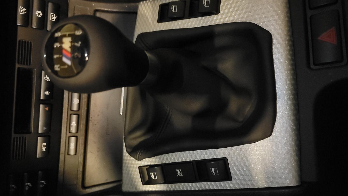

    I recently got a set of aluminum cube trim, however the drivers side switch cut out on the shifter surround must have new from a convertible. So it while my existing switch clipped right it, it didn't look quite right with the extra blank space.
    So I put in a sedan window switch, which works for both windows but obviously the window kill button doesn't do anything.
    As far as I can tell, it's two extra pins, probably Normally Open. any ideas if I can re purpose the button Click image for larger version

ID:	253195 for something else?
    Unexpected benefit: the rear window is now one touch close with this switch. I remember trying to code that in before but I guess it needed the hardware to work

      You could put in the convertible switch, and wire 2 extra wires to the GM5 to actually make the all windows down button work.
        Interesting, is this something you have seen done? I would think that would need some coding on top. Running the wires to GM5 is easy, I like it.
          I considered doing it myself, it indeed requires you to enable the button with NCS, but it seemed like a cool mod to me, never seen anyone do it.
            Awsome, it's just enabling the button, seems like a worthwhile mod. I'm going to check it out
