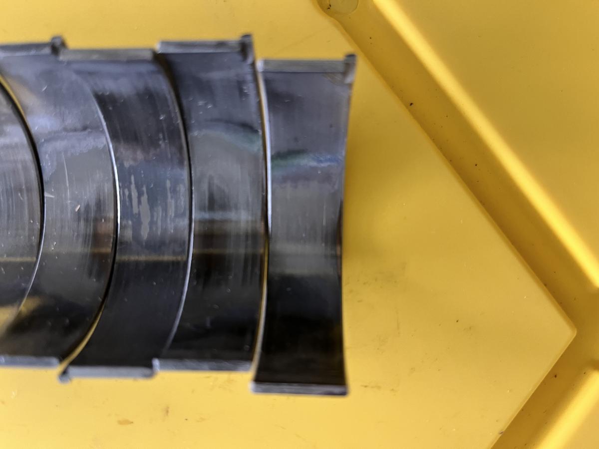

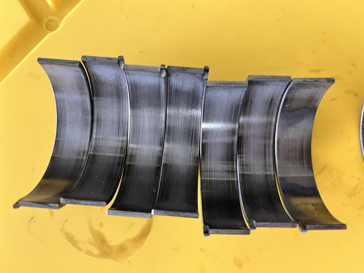

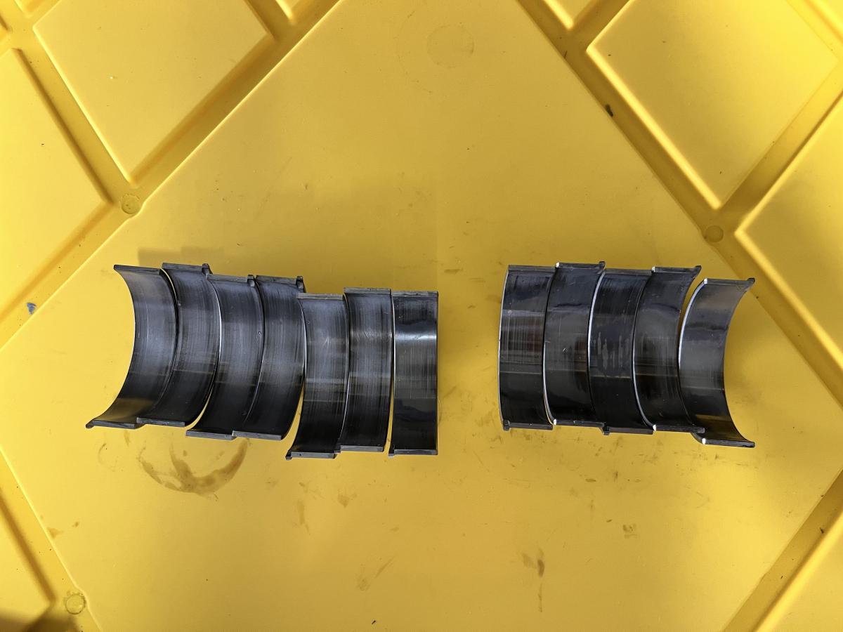

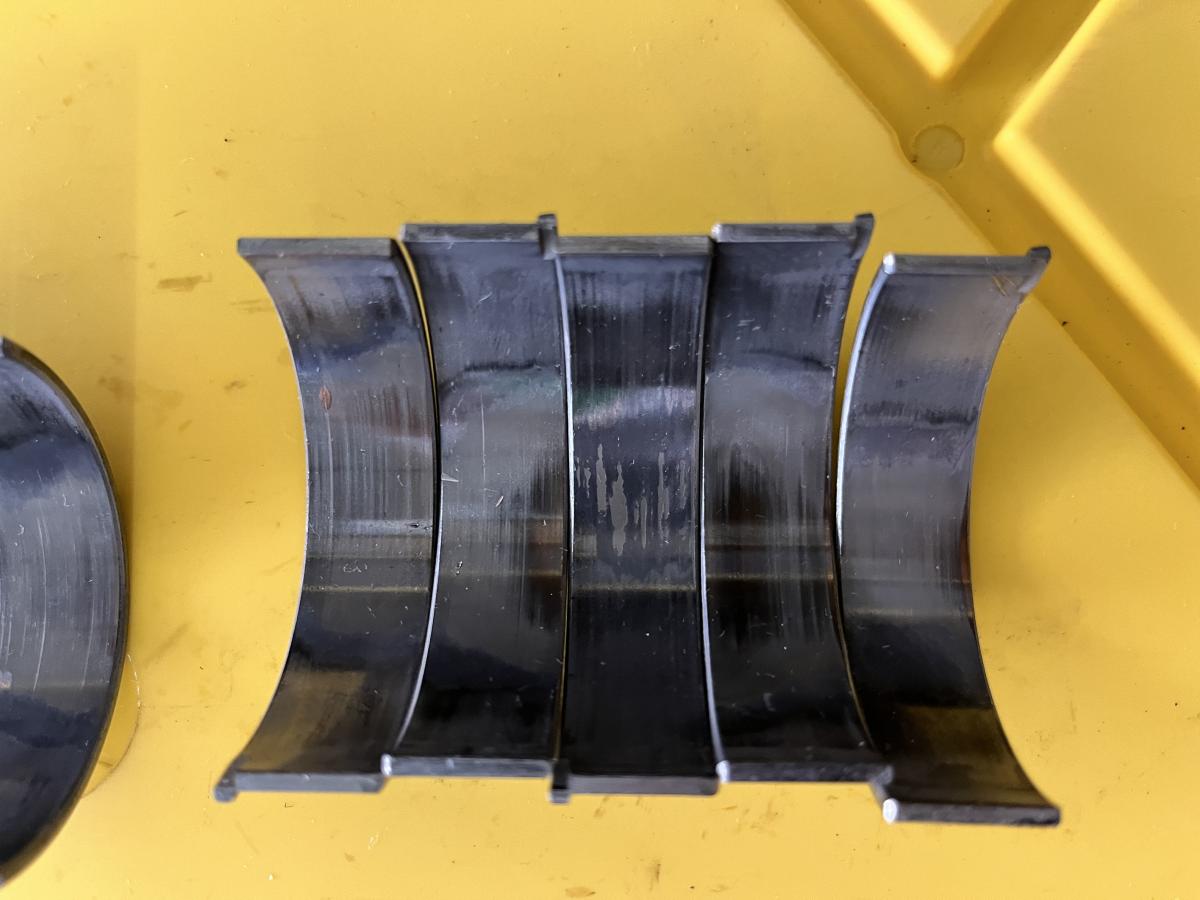

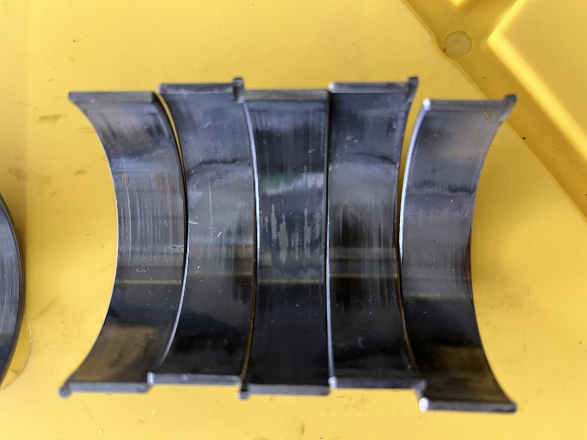

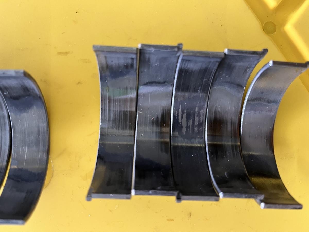

    Recently had EAS in the OC do my rod bearings.
    they said they looked ok. What are your thoughts?
    the car is 2003 and it was the updated version installed during the RB campaign at 7000 miles. Took them off at 80k.
    would love your feedback. I separated them so the ones on the left looked like they had more wear but I really don’t know what I’m looking at.
    Those look pretty good to me. Better than the two I have done at 80k.
      Some of them show copper, so it's perfect time to renew.
        Could have gone a lot longer
          Those look great for 73k miles. I would still do them again at 150k. You're at a good point to preventatively replace them. They aren't perfect but also no real risk of spinning.
            Thanks for that!
            It’ll take me a looooong time to get to 150k but hopefully I’ll let the car til then. Is this a time based maintenance item or just mainly miles?
              Fairly average for 73k miles, probably a bit more wear than another I have seen with 120k miles. Could be down to oil change frequency and warm up procedure.
              In your first picture, you have 6 lower bearings with the seventh one being an upper bearing shell and that one should be grouped with the 5 upper bearings on the right. The uppers are the ones that wear more and show bearing wipe. Yours were getting into copper on a few, so while they probably would not have failed in 10k or 20k street miles, they were getting there. New bearings can easily go 100k street miles depending on how you operate and maintain the engine.
