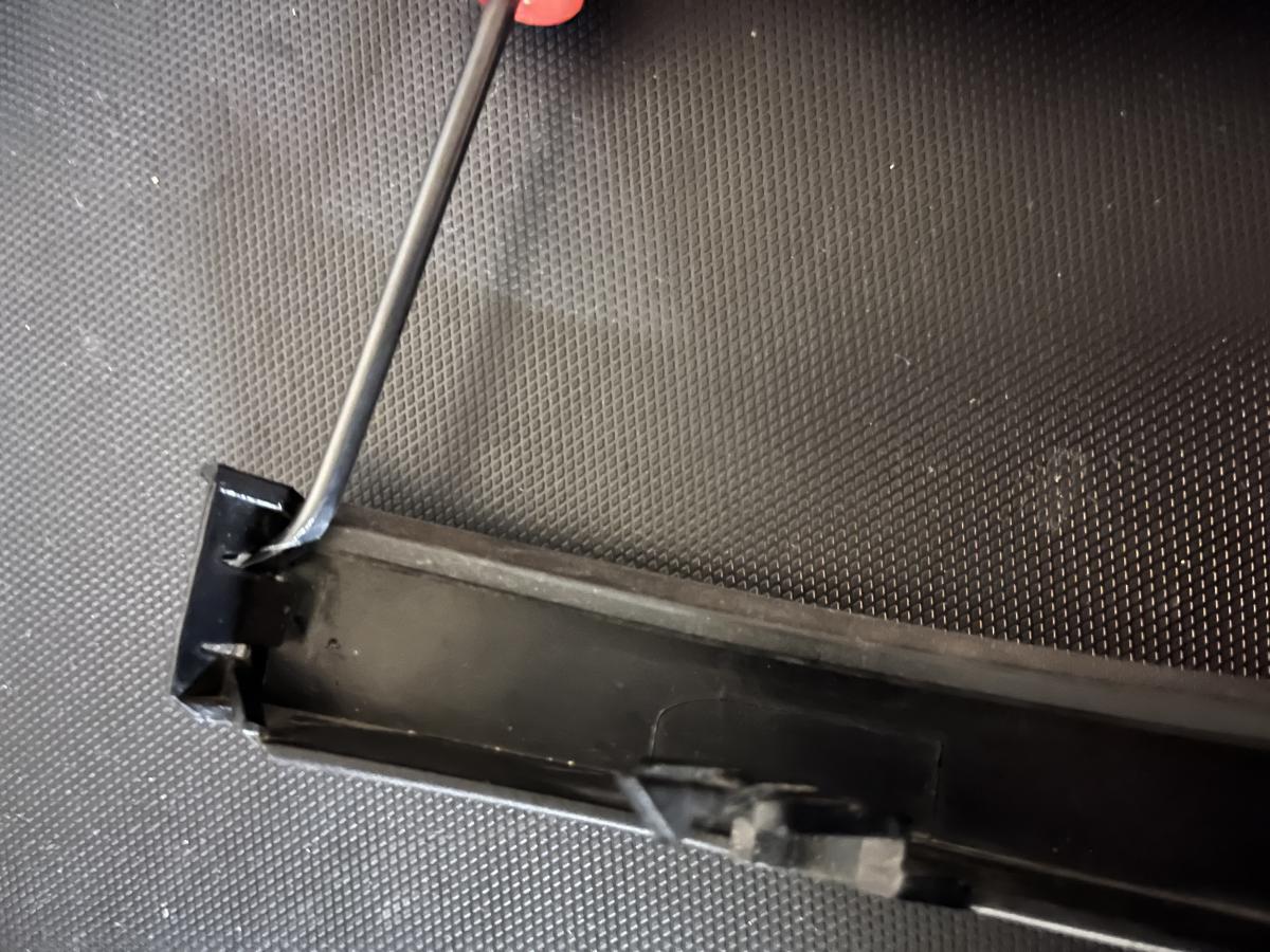

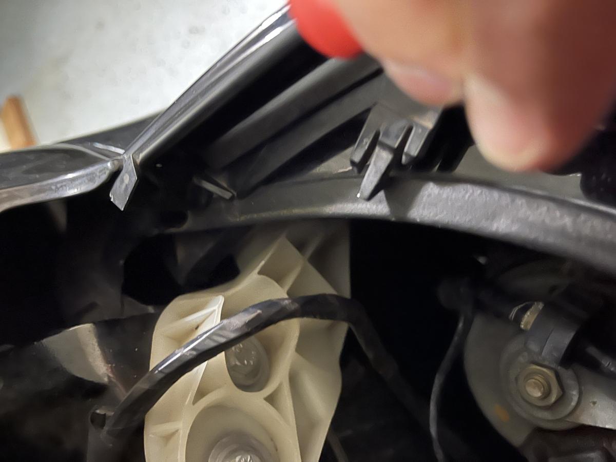

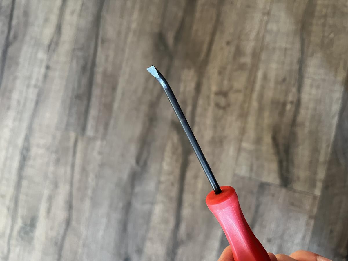

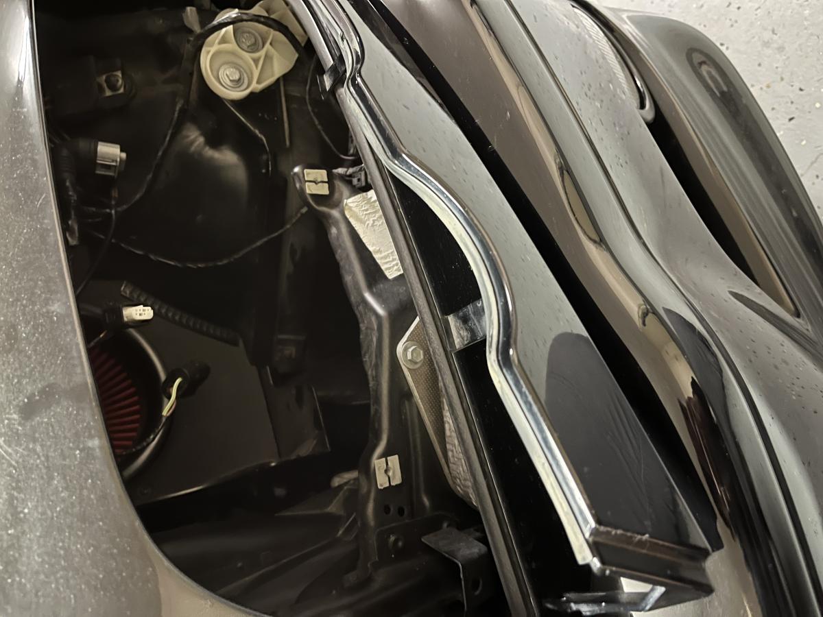

Gotcha. I have my headlights out currently to get upgraded. Here’s what I did.
Rotate the trim forward about 30 degrees. Then used this mini pry bar. Get it in the tab levering it back while pulling the trim straight back with my other hand.
Hope this helps. Still 20 yr. Old plastic still may not be forgiving.

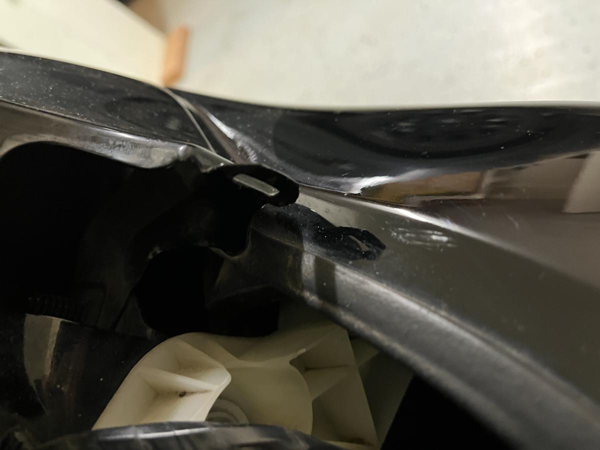

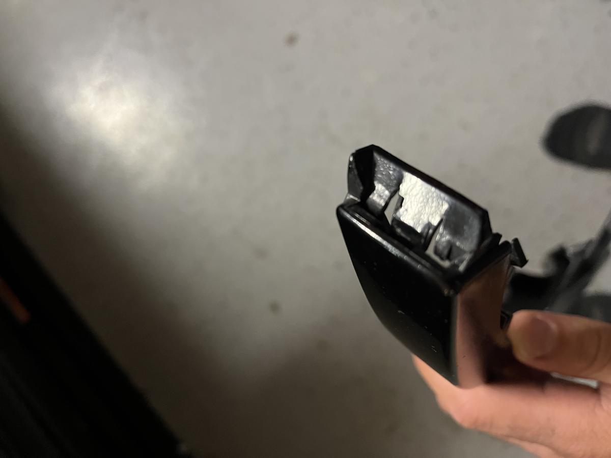

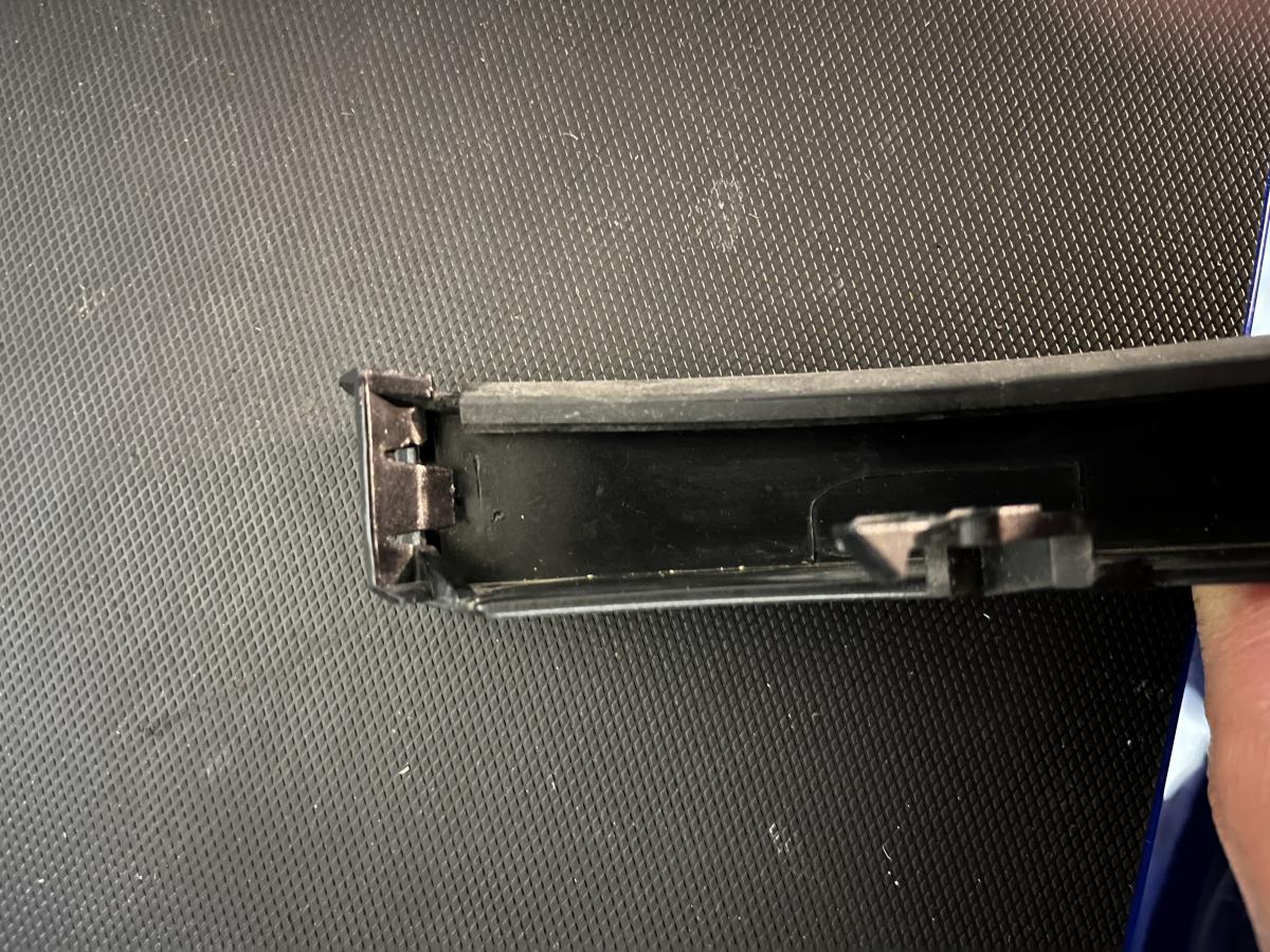

THANK YOU! I think it makes a little more sense. You said you have currently have your headlights out? If possible, would you be able to send me a pic of the plastic tab of your trim (the side by the corner lights)? I'm trying to get a better idea of how exactly it clips in.Originally posted by E11even View PostGotcha. I have my headlights out currently to get upgraded. Here’s what I did.

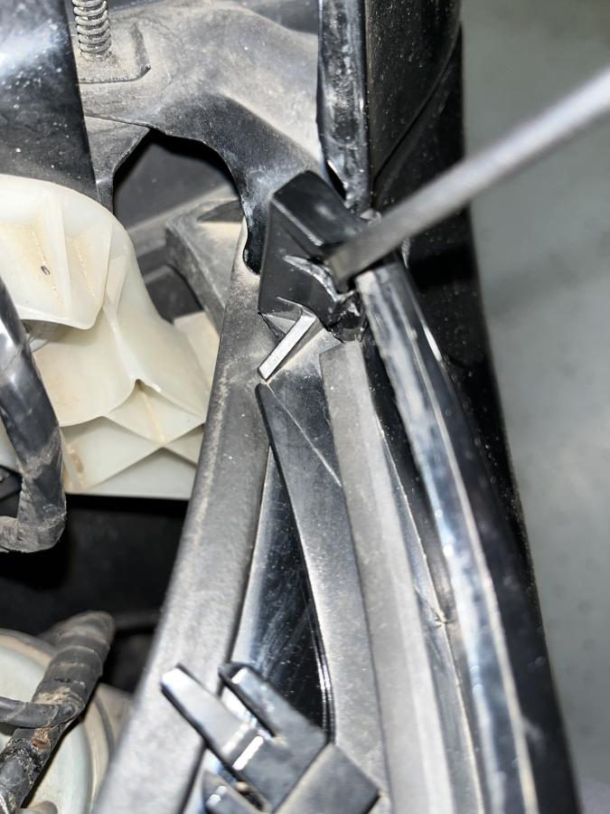

I just replaced the lenses on both my headlights and that trim was a f-ing nightmare on my passenger side. I watched the FCP euro video of changing the lenses and they made everything seem as easy as possible. I had to use a pick like the posts above to get the one side out. Only by looking at the other side and seeing how it locks in. Basically just push the tab with the pick and slide it out.

That's exactly what I use - a small 90° pick tool. The videos don't explain it to well, but once I shined a flashlight in there to see the clip, it made sense.Originally posted by Kevin2772 View PostI just replaced the lenses on both my headlights and that trim was a f-ing nightmare on my passenger side. I watched the FCP euro video of changing the lenses and they made everything seem as easy as possible. I had to use a pick like the posts above to get the one side out. Only by looking at the other side and seeing how it locks in. Basically just push the tab with the pick and slide it out.
Those photos of the trim piece above should be helpful.
