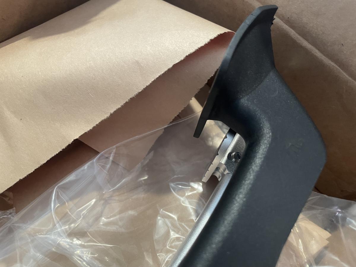

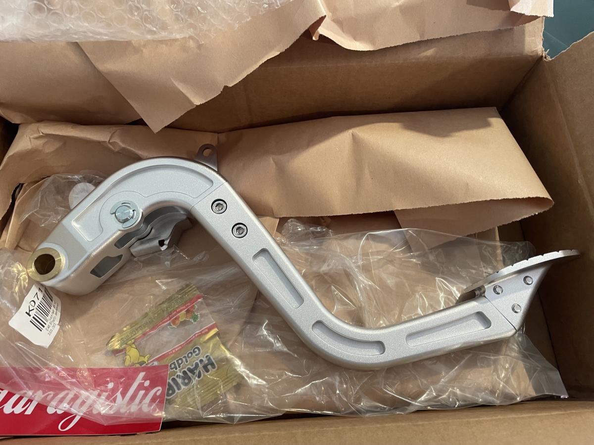

                  I decided to go with Garagistic, I am short and really did not need the clutch to be any shorter. I received the pedal today, and I have to say it is really well made, the pedal is beautiful and all the machined parts look high quality.

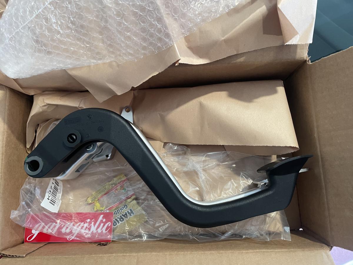

                  I took photos to compare to the OE pedal, and the garagistic piece is a 1-1 copy except for the step portion which is a bit shorter, this reduces the offset the clutch has relative to the brake pedal, but it does not make them level as seems to be the case with the Rogue Engineering one.
                  the only negative part is that I could not install the stainless steel cover as the curvature of the new pedal is flatter. I need to figure out what I am going to do, for now I just put the pedal on so I can drive the car.

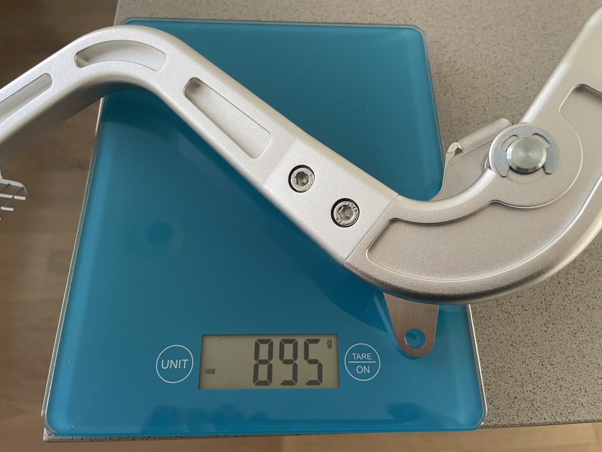

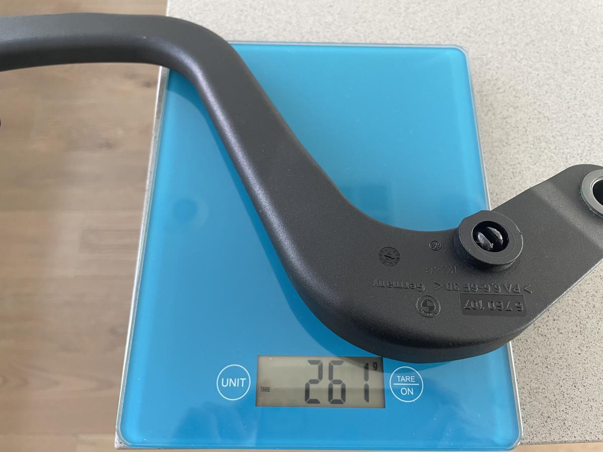

                  the billet pedal is more tha 3 times the weight, so is a negative, or positive, my clutch was a bit heavy and this helped to make pressing the clutch less effort.

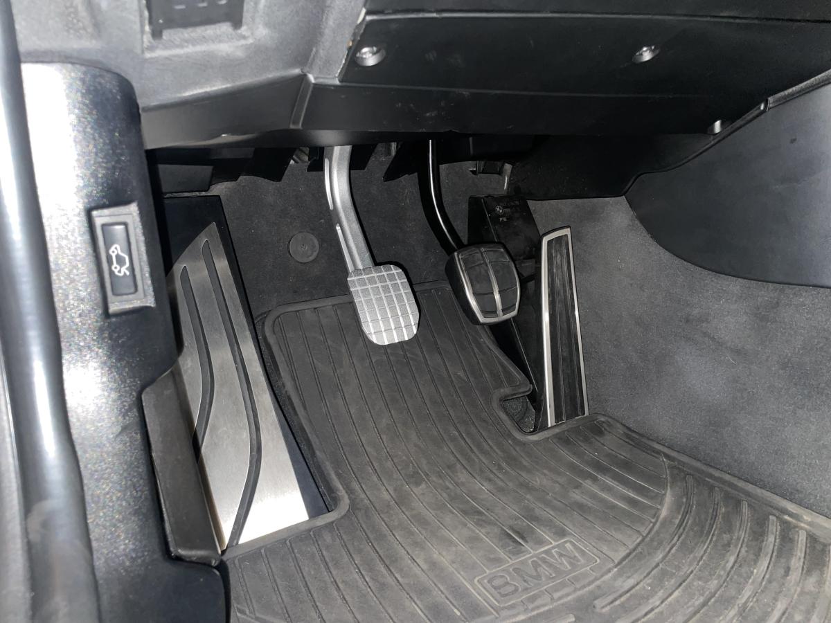

                  this is how it looks now, not loving it but is also not terrible.
