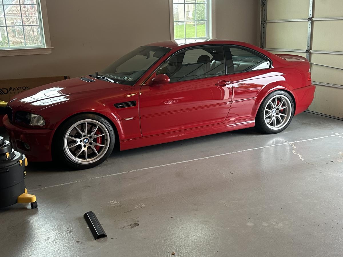

    Hey Guys - been thinking on this a bit and looking to replace my street Apex FL-5 (18 x 9 et 30 fronts & 18x10 et 25 rears ) with these specs:
    RIA 07 in DSK silver - 18x8.5 et 34 for front and RIA 08 in DSK silver - 18x9.5 et 23
    Im assuming these will clear my Brembo GT 355/345 front/rear also without spacers but wondering if the experts on here have an opinions on the sizes/offsets of these RIAs with the same PS4S or Cup 2s in 245/40 and 275/35 as I run on the Apex now.
    id like it to look the same if possible: Click image for larger version  Name:	IMG_0794.jpg Views:	0 Size:	142.2 KB ID:	260448

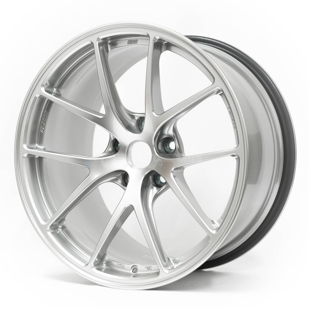

    How have I never heard of those wheels before!? The looks great/strong/light!
    ... according to BBS's fitment guide, they will not clear the 355mm Brembo GTs. I don't know if that's actually true, as it seems unlikely BBS tried all brake options on a 20 year old chassis. They sure LOOK like they would have good brake clearance. Which if they did, would be amazing-- there finally would be a compromise free 18" street wheel for this car.

        RIA009 18x9.5 et40 should juust fit perfectly up front with a 255/40/18 or 265/35/18 if you don’t have a coil over perch getting in the way. That’s THE perfect front wheel! Now I want M3 front fenders

                Technical Details: Forged Monoblock Construction #SystemSpec fitment Recommended fitment for: E46 M3 / E9x M3 / + more. Will work with a variety of other vehicles as well. Please reach out to us if unsure about compatibility. (2) 18x9.5 +23 / (2) 18x10.5 +22 / 5x120 Finish: Diamond Silver Valvestems Included + Centerca

                          I am quite sure they would clear, but actually Apex has a whole bible of fitment questions and answers on their website. TC Klein should be considered high clearance and have no issue clearing the spring with a wheel like the BBS RI-A in a 9.5 ET23. BBK, same. Expect to run some camber though, probably -3 degrees in the front. You can contact System Motorsports or Slicer Paddock and ask them, those guys are both BBS dealers and they will know the answers 100% and they have a good gallery of different wheel fitments to show.

                            If you want a nice flush fitment, no spacers, no aggressive camber I would do the following.
                            18x9.5 et27 245/40/18
                            18x10.5 et25 275/35/18
                            This is the spec I'm running but with wider tires. They're beautiful wheels btw!
