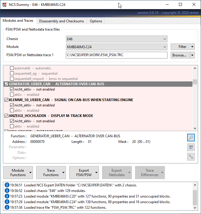

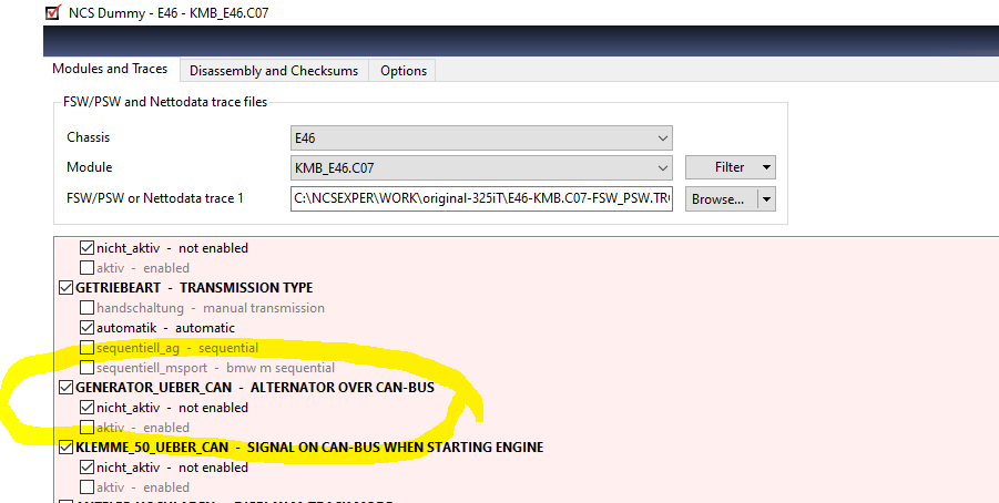

                      To verify that the red BATT is driven directly from DME or CANbus, you can use NCS-Dummy to read the dash cluster KMB trace file FSW_PSW.TRC, then look for GENERATOR_UEBER_CAN keyword to see if it's enabled or disabled. Yours should be enabled I think.
                        So it seems like red BATT light is driven from DME as this feature is not enabled. Am i reading that correctly?

                          I wrote “For M3 before 2004/03 the batt light is driven by DME directly; from 2004/03 it is controlled by DME via CANbus.​”
                          Yours is pre 2004 so no CANbus for cluster battery light control, but I mistakenly said the opposite in my previous post. Your KMB data confirms this.
