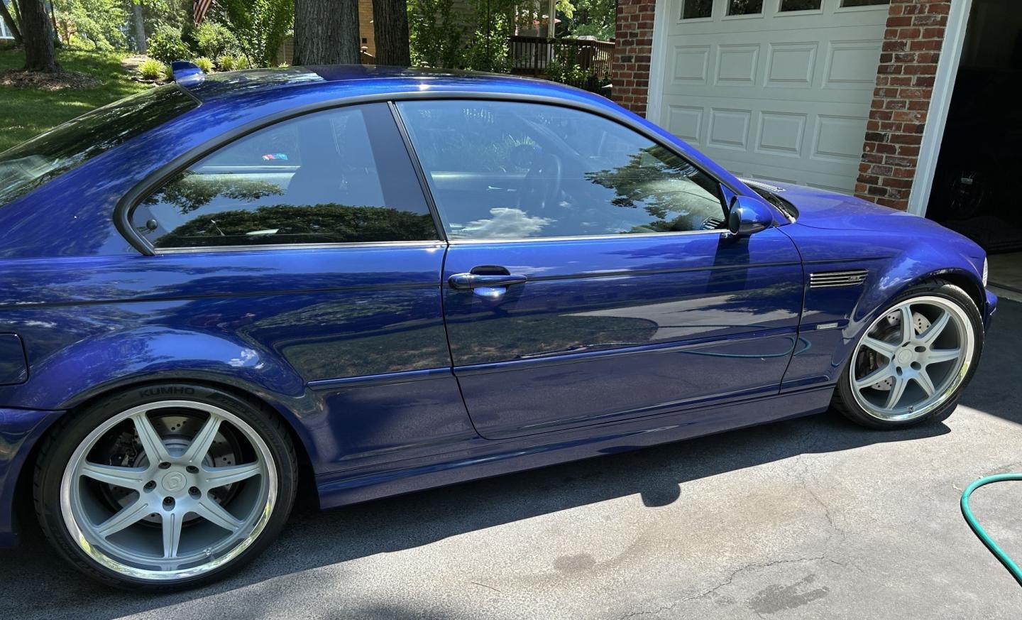

    Question for the collective. May have line on set of E46 Dinan Champion wheels. If I decide to buy will I have fitment issues? Wheels are front 19x9, +48 and 19x9.5 +45. Car currently has OEM Comp wheels, 19x8 +47 and 19x9.5 +27. Currently running 235/35 and 255/30 tires.
    Bonus question - best tire sizes. The wheels Dinan sells today for the E46 they recommend 265/30 and 275/30, while on the Champions they rec'd 275/285. TIA.
    You're going to want to run a 20mm rear spacer for approximate factory spec, 25mm if you want a little more flush, and probably a front spacer of 10-15mm but that's more subjective looks wise. Some front spacer may be required depending on brakes and what suspension you have. 9 ET48 is going to be a bout half an inch closer to the suspension than 8 ET47. Plan on extended wheel bolts or studs as well.
    I would ignore those tire recommendations, for a 9-inch front and 9.5-inch rear, I personally would just go with a 235 front and 265 rear.

      FWIW those are the regular 3 series Dinan wheels, the ones for the M3 are 9.5" front and 10" rear. You can make the smaller ones fit with spacers, but the actual M3 wheels were designed for our chassis.
      F: 19x9.5 ET45
      R: 19x10 ET35​

              Appreciate the replies. Edit to close the loop - yes they do fit with no spacers.
