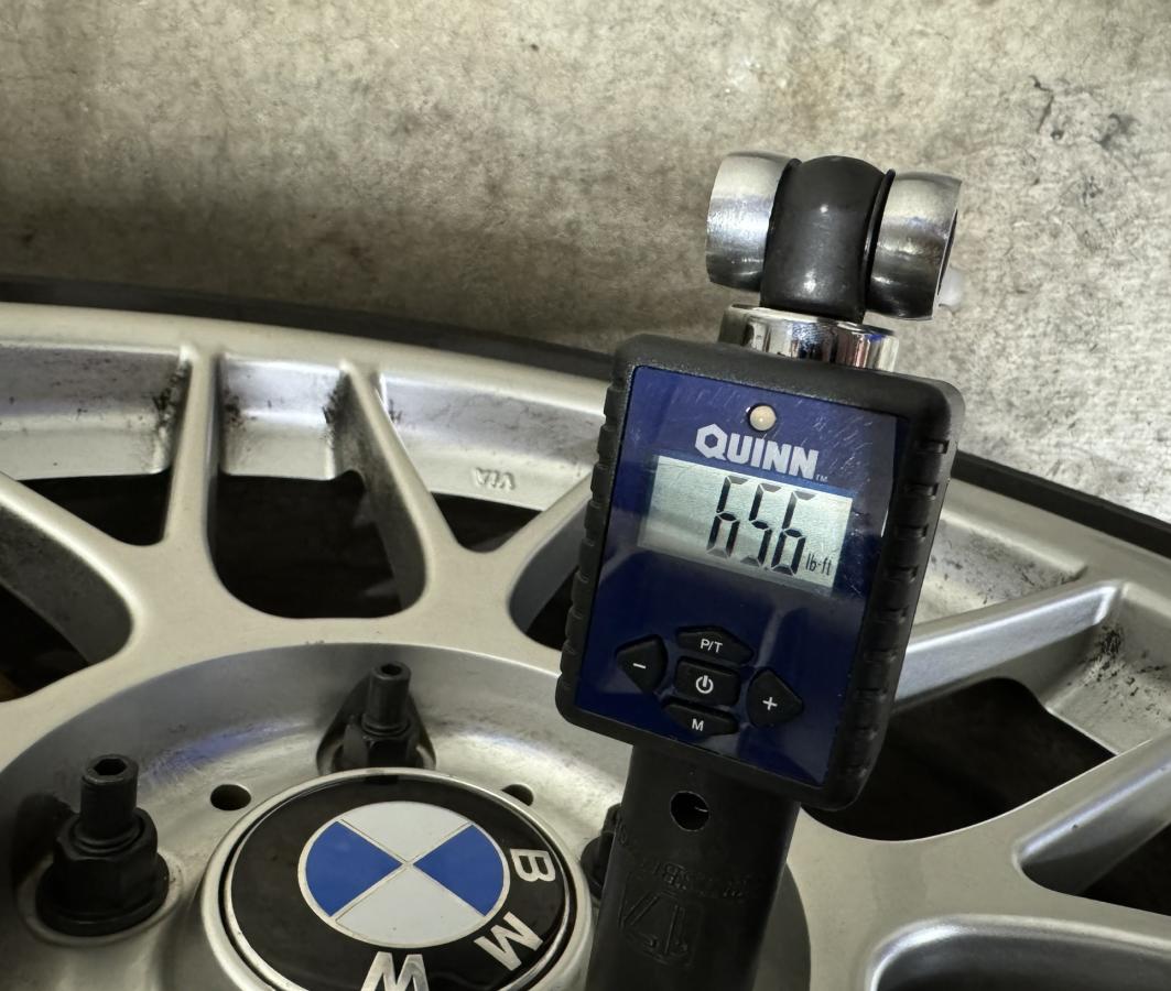

            Ok this is interesting. I went out and measured and found that the fronts were down to around 65-70 ft-lb (from 88). I'm not sure if that would be enough to notice or cause issue?

              At a minimum - inspect your stud threads very carefully.
              If it were me - I'd replace the studs and bolts on the affected wheel. If this cures the problem - toss that hardware.

                It is normal for a nut to have a lower loosening torque than tightening torque, but it's worth looking into.
